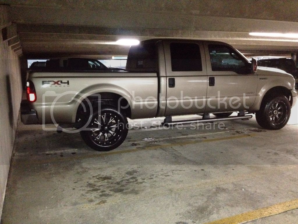

Would it be better to drop the rear blocks out and get new u-bts or get the 1" or 2" optioned shackle drop kit off ebay..I plan on traction bars later too or cal tracs..

almost. and yea 250.
there is a slope to the 2nd pic towards the front of the truck

Almost there..thanks for the pic. I'm probably gonna go 2" still just a bit high. Good lookin rig man. Almost looks like mine! Like those rims

thanks man. if you remove it all together id get new shorter ubolts or if you dont plan on going back up then you can cut the stockers so you can still use a deep socket.

I like the look of that A LOT. Looks GREAT man. You could put a light trailer and not be dragging a$s. LOL

^^ LOL what I didn't want to do...was looking for u-bolts at the auto parts stores but can't seem to find any...that black truck is siicckkkkkk!
