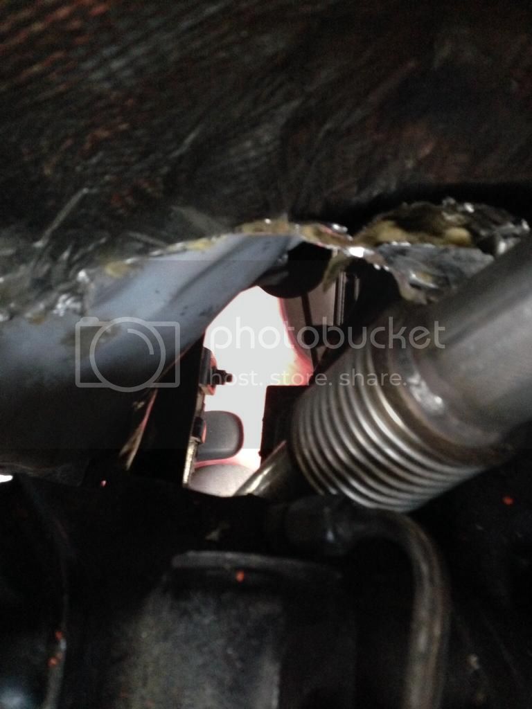

Time is tight, only 45 minutes to work on it today. Here is a pic of the firewall insulation removed for downpipe clearance. I still have to use my freshly repaired duckbill for my portapower to make more room, I am also going to try loosening the motor and trans mounts to squeeze a little more room.

I ended up trying something different on the firewall, the screw jack from my beater Civic. That screw jack is the real deal. It has worked a lot better than my duckbill on the portapower. This evening I removed the downpipe, turbo and up pipes; pushed on the firewall; reinstalled everything; removed everything; pushed some more; reinstalled everything and need to remove everything one last time for one or two last "adjustments" and I should be good. All of that will happen Sunday when I "should" have a solid 8 hours to put into the truck.

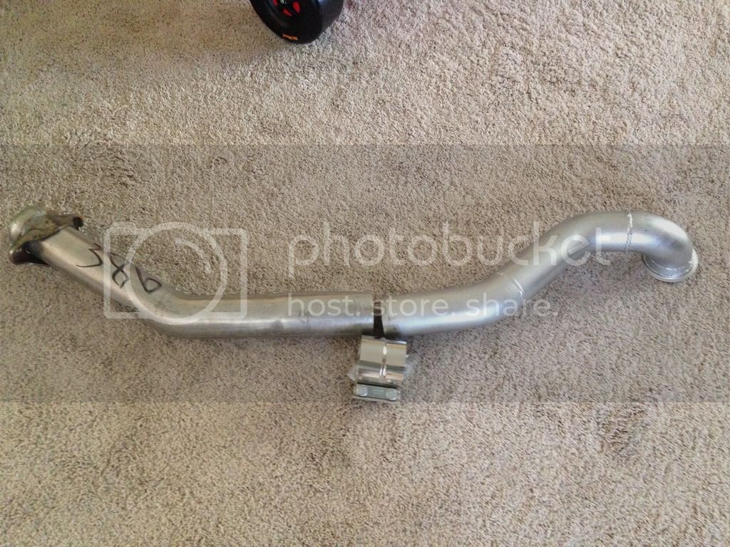

Oh BTW - the OBS kit now comes with a DP
http://www.powerstrokearmy.com/forums/showthread.php?t=61553
Billy T.
[email protected]
Jake took great care of me. My truck has been down since mid January with this install. I received my new down pipe on Friday and I installed it tonight. It fits darn well with the massaging that I already did and makes connecting to an existing exhaust system very straight forward. I managed to button up 75% of the rest of the stuff that I waited on the down pipe for. With work and chasing kids the rest of this week, I should have this thing back on the road Saturday.

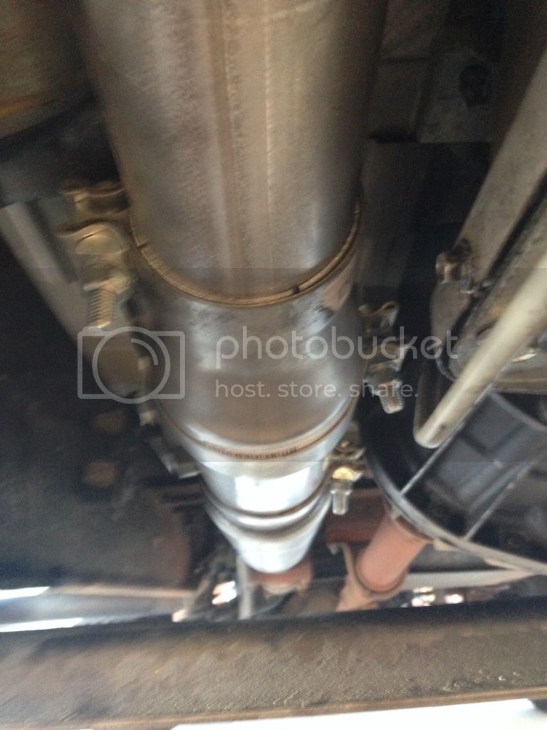

I finished it up tonight and took it for a 10 mile shakedown run. No oil leaks so far and I don't think there are any boost leaks.
Boy I missed driving this truck. And now with this T4/366 setup, it is an even bigger blast to drive. It pulls stronger in the lower RPM's and EGT's are down 100-150* across the board.
Here are a couple of bad pics of how the new Irate downpipe connected to my existing MBRP exhaust. I will get some better pics in the next couple of days.
