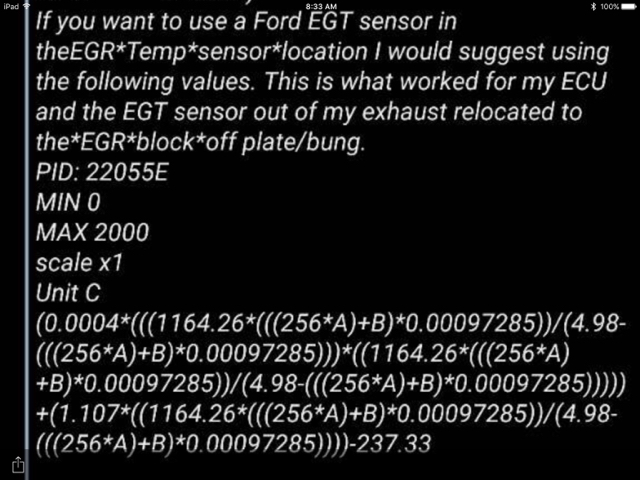

There is a sensor labeled 'EGRT' on the top side basically in the same location we use an OEM sensor for EGT's on the 11-14 trucks. What I'm attempting to determine is if this sensor, by itself, can be used to monitor pre-turbo EGT's.

The PID listed above is what I use to monitor pre-turbo egt's with my Torque Pro App in my 2015. I have an OEM probe out of my exhaust installed in the EGR blocker plate that is plugged in to the EGRT plug.

So, yes, I'd say that sensor, by itself, can be used to monitor pre-turbo egt's on the 15-16 trucks. Or at least for sure the 15's because I'm using it.

We have been working with E-Motion for several weeks now to get the nGauge functioning like it should for you guys. There have been additions (BOOSTC, EPS_1C, ECT, etc.) and fixes (FRP_A and EGT_SP). I have been testing beta firmware v215 for several weeks in my 2012 without issue (minus EGT_SP as I don't have a sensor). I do, however, have confirmation from one nGauge user that EGT_SP does work with an EGT sensor in the EGR block off plate for 2011-12 trucks. It doesn't look like 2013-16 is fixed yet.

I installed new firmware for Ngauge this morning. The firmware works great PIDS now accurate. EGT PID now works I can see pre-turbo EGT'S with blockoff plate installed into right manifold. New scaling option for certain gauge options. I would like to see the boost gauge scaling be able to go higher the 30 psi on the round gauge option 0 to 30 max visual scale only. I don't know if there is a option haven't found it yet but it would nice to be able to change background color to make readings more visible. When sunlight or light hits gauge digital numbers almost disappears have to block sunlight to see readings while driving.

I have a 15 running ndash. Boost seems to be working now but I tried all the egt pid's and couldn't get an accurate egt reading yet. I have egt 11 out of the exhaust in the blocker plate plugged into the egr. I have one that reads but it bottoms out at 568 and I can hit 1400 like nothing on level 3 so that didn't seem accurate. Getting closer thou
