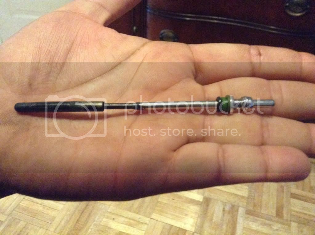

So after driving home from a night out with the family, my 08 decided it didn't need the #7 glow plug. Anyone ever have this problem? Am I screwed?

Wow, thats the first time I've seen that kind of glowplug failure. No contact marks on the tip? You should be able to unscrew whats left out of the head. Did anything else get damaged like the harness?

I can't seen any damage on the harness, I'll find out when I put the new plug in.
As far as how I knew it spit it out, I was driving like normal then i heard a loud pop and loud compression leak, kinda sounded like an old tractor. lol

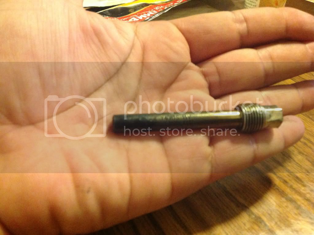

UPDATE:
Finally got the truck running again, turns out the OEM motorcraft glow plugs are made by NGK. Anyhow here's the pic of what was left inside the head.
