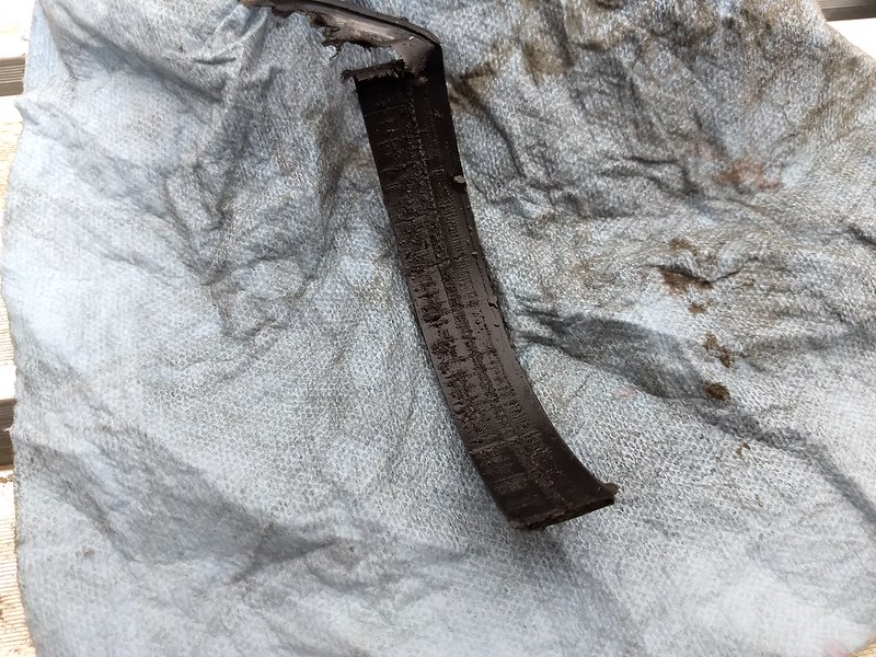

Decided to tear the truck apart to get ready and pull the engine. Pulled the water pump off and found this guy behind the passenger side coolant opening in the front cover. I'm pretty sure it's not supposed to be floating around in the engine lol. Found out the coolant has oil in it.
IMG_20190309_172830134 by greyford79, on Flickr
Can’t tell from picture but what is it ? Is it metal it looks like it is fiber of some sorts If you are not finding a lot of metal in the oil I don’t think you spun a bearing. If you have oil in the coolant it could be oil cooler o-rings going bad.

Not sure what it is, all I know is that I pulled it out of the engine. No oil in the coolant. I have major coolant in the oil. Won't know exactly till I tear it down. Engine has low compression anyways. Both valve covers were covered in the oil/coolant sludge.

That's the first thing I thought of when it happened. Also I think I figured out my mystery piece I found. I replaced my water pump back in the fall, and thought that it was still the original pump. When I put the new one on, I had to remove a ring that was around the fins to keep them from being damaged in the box. This piece looks just like half of the ring. Now I'm wondering if someone before I owned the truck had replaced the water pump with the same one and didn't remove it. Just crazy it's been in there this whole time.
