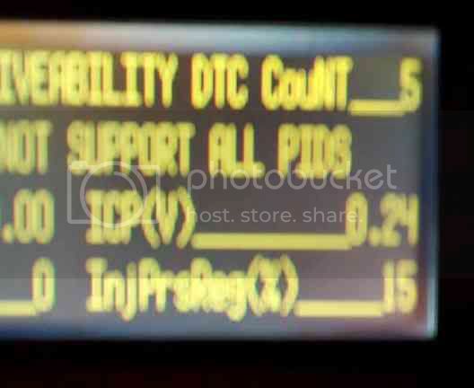

Ok I know its been a while but we got a SnapOn scanner and took some vids. First is with engine cooled off after about 5hrs.

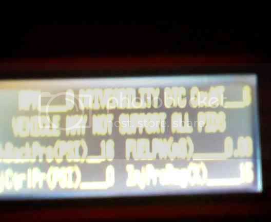

Second video shows icon and ips on a full throttle run. As y'all can see it ain't right. I peak out just over 1856 and 86 percent. Not good at all.

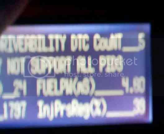

Finally trying to hot start. You can see it barely gets to 400psi.
TARM
May 19, 2011
2,439
That could be helpful for others than may have a similar issue possibly with any hpop pump.
Have you contacted Gary yet about this issue?
