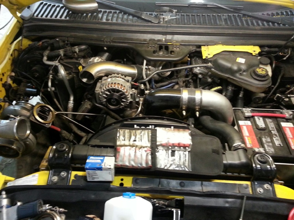

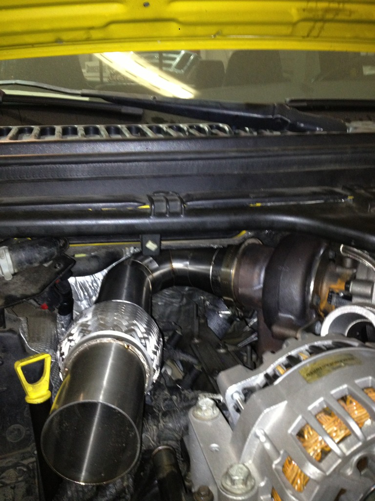

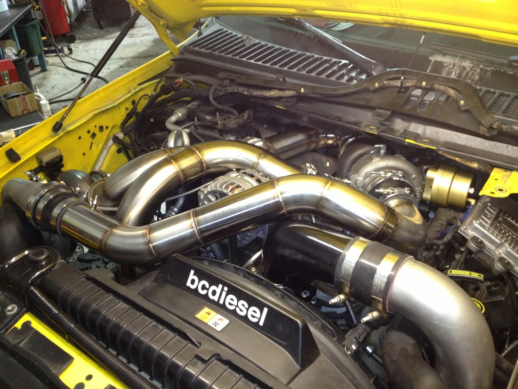

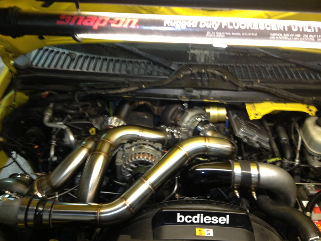

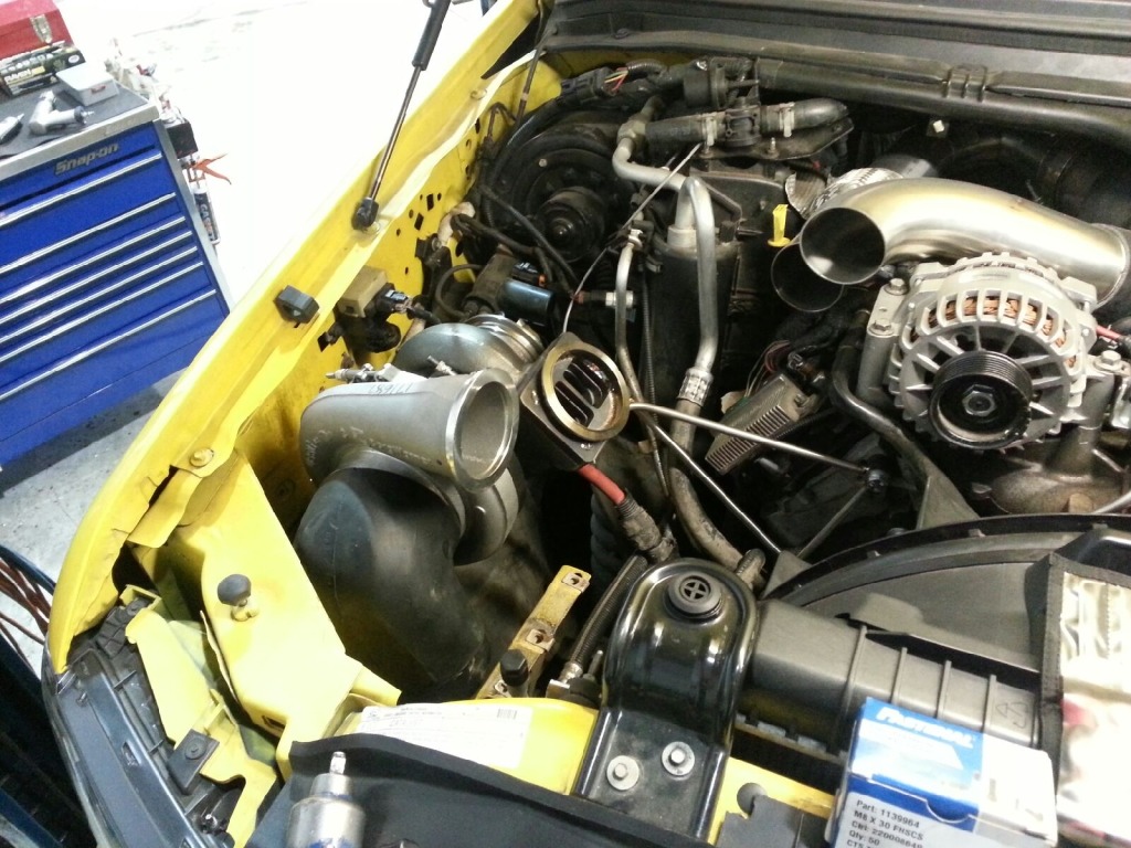

Small update starting the hi pressure to low pressure pipe using 3" stainless

Well its pretty much done went to go do the first fire up and nothing cranks and cranks and cranks but nothing HPO is 0psi and low pressure oil is 60psi.... Have updated hpo fittings, stan pipes and stc fitting also put in a new pump while it was all torn apart...Back to the drawing board..
