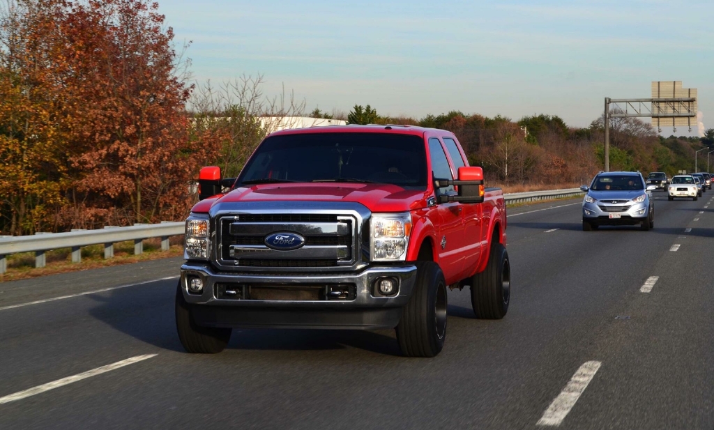

20x10, -24 offset, 35's. Let me know if you need some prices on wheels.

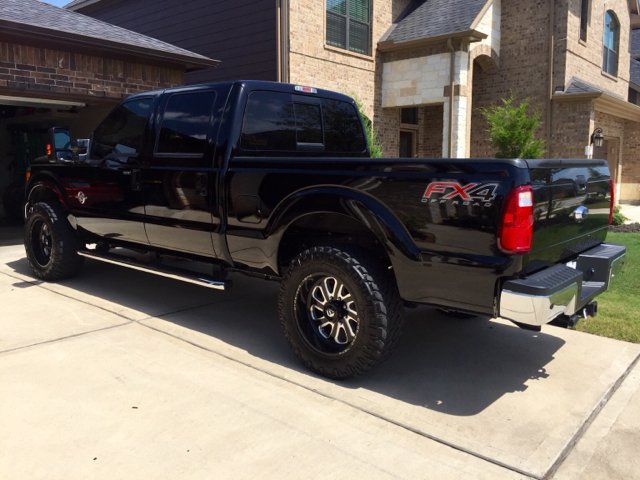

20x10 -18 with 35" Nitto Trails at stock height. Bumper spaced out 3/4" and fender liners pulled back.
