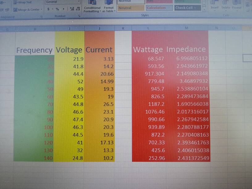

Also the impedance of a sub alone isn't the end result impedance. I know this may go over your head but a box and its instilation will affect it. For example, my sub is wired to 1 ohm (quad 4ohm coils) yet at across the curve it was anywhere from 6.9-1.6 ohm. Here is a rough chart from where I played with a frequency generator and a amp and voltage meter. Yes I was bored one day waiting on friends to show up to go on a lake road trip. uploadfromtaptalk1394293420888.jpg

Right, we have all been talking nominal impedance. Like you said impedance rise is well over most peoples heads, and just 1 example of why gear selection is only a minor part of an overall system and proper installation is the biggest key to good sound.
Quad coil is pretty rare usually just on the bigger SPL subs. Just curious what sub you are running?
