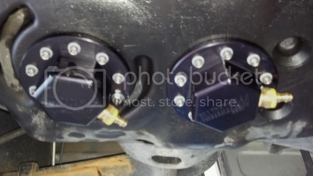

IF the need ever arises for anyone to run two sumps you can put them pretty much anywhere in the tank. They will force angled or slopped surfaces to conform to the sump.
I am running two sumps on my wife's mega cab that I built for her and neither one of them leak. One sits in the flat spot bellow the sending unit and the other one is in the slopped section of the tank as close to the flat as I could get it.
