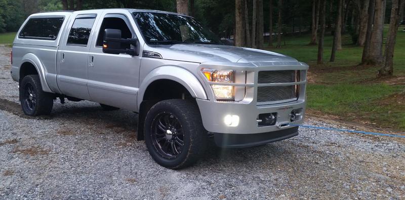

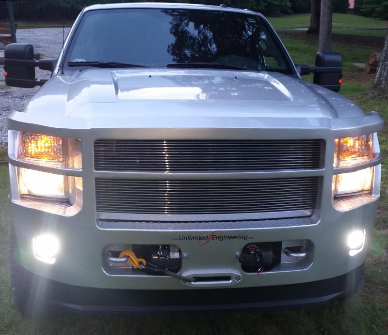

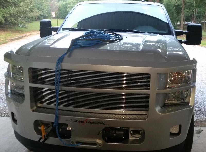

I've had this synthetic rope here for a while now and finally got around to installing it. Wish I'd done it sooner.
It's so light it's amazing and the fact that it's plastic means I can throw it up on the hood and not worry about damaging the paint.
note: this didn't work as well as I'd hoped as the truck is well waxed and the rope tended to slide around as I was moving the truck. Maybe drape it over one of the wings next time.
Todd over at custom splice suggested the 'knot' method on the 6th wrap. I was able to get this to work and I think it's a great idea to keep the line from pulling off the drum and it works great. More on this later...

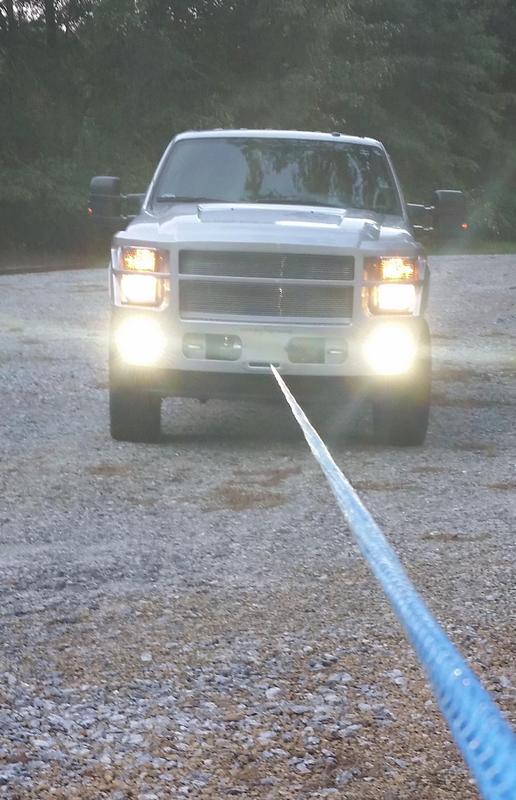

So I got it to a good spot, hooked up to a big tree, set the ebrake and started a nice long pull to wind the cable.
I think the fairlead looks a lot better than the roller unit. I wasn't too sure how it would react to the curve on the bumper, but I just tightened the bolts down and it bowed to match the bumper.
I don't like the Yellow hook, so I've got to paint that, but otherwise I think this was a nice upgrade.
Got the fairlead and synthetic line from Custom Splice, there were a few problems with the order, but they did a good job of straightening them out and all is good here.

That synthetic rope is really nice and much tougher than people think. Chippers use an almost identical rope for their winches and they take a beating before they rub through or break.

Dang that bumper looks good! Yeah the synthetic rope is awesome we use a ton of it. Another nice thing is if it breaks it's a lot less likely to kill you like wire rope and chain will. It will scratch your hood once it gets embedded with some dirt....

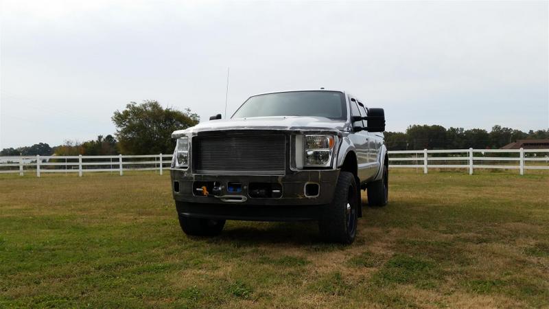

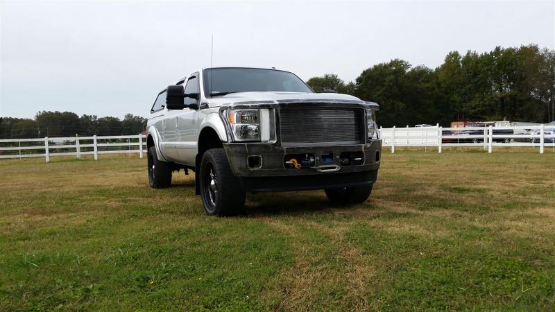

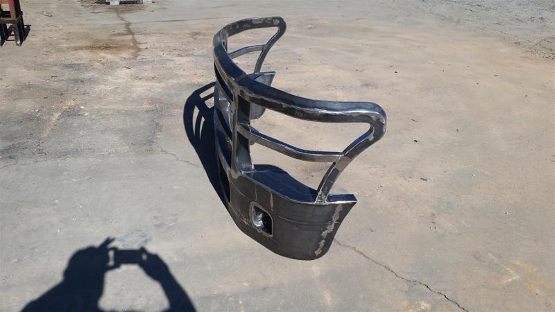

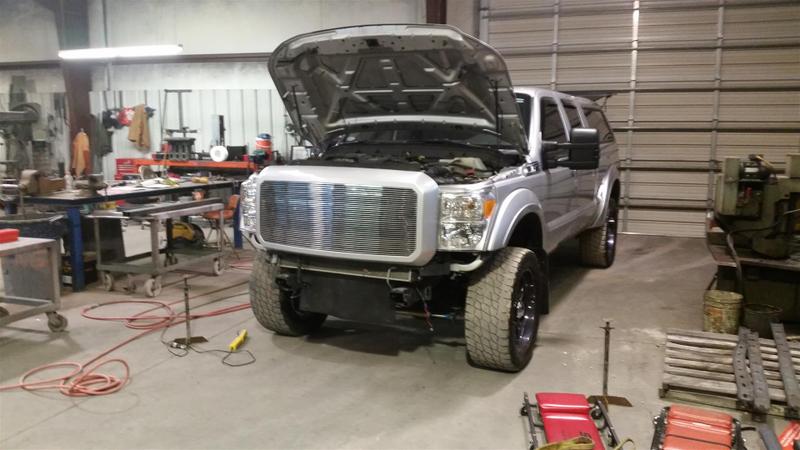

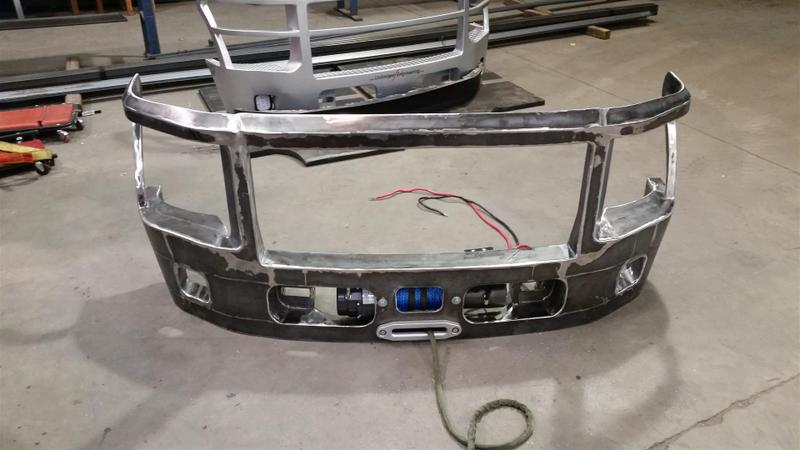

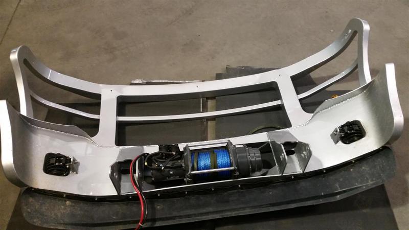

I know, I've been quiet for a while, I'm sure y'all have been wondering.
Starting a new production line and all new technology is not an easy task, we've been working hard.
Today I took my bumper (2nd prototype) off and test fitted the first production piece to my truck. Yes, I know the center bars aren't on it, the tooling to bend the wings got messed up and they have been delayed. Still, I thought you all would like to see where we are.
Here's the 2nd prototype coming off the truck.
Fitting the Warn 16.5TI winch into the new bumper.

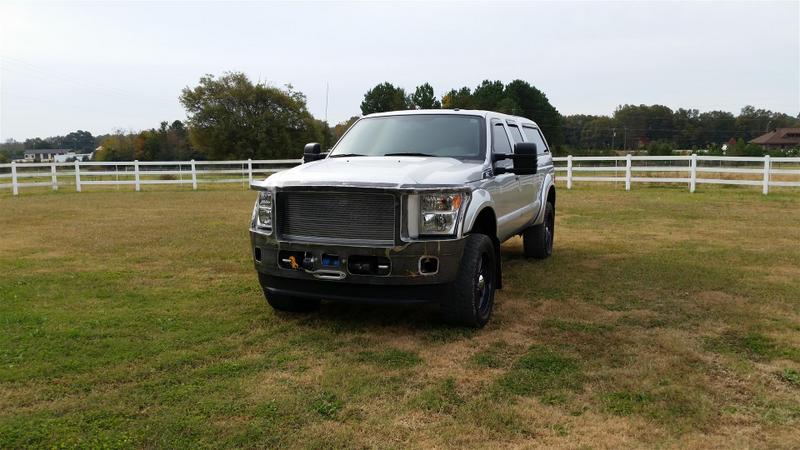

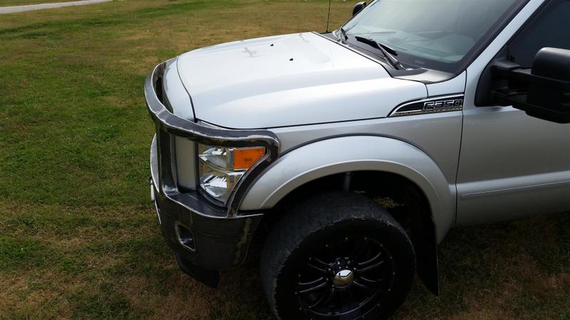

A few beauty shots of the new bumper mounted to my truck. Fits like a glove. Hope you enjoy.
We'll finish up the center bars shortly and ship this one off to it's new home.
A lot of work in these babies that's for sure.

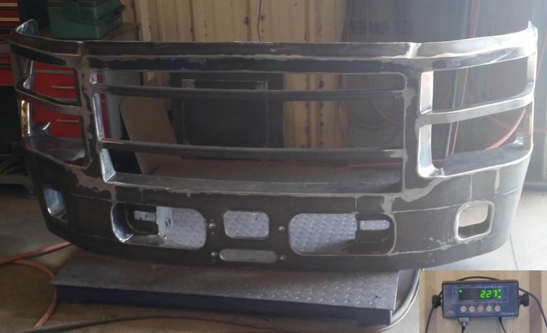

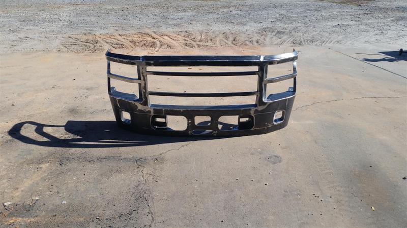

Done!
On a pallet and ready to ship to the customer.
With the double center bars it's 227lbs.
Center bars are about 7lbs each, so a single center bar version would be 220lbs.

It goes on really easily.
Take all the stock stuff off, save the hardware, attach the winch, slip the bumper on, use that double bolt that's stock to attach it. Adjust it and tighten it. Then if the body isn't centered loosen the cab bolts and adjust it. This isn't due to problems with the bumper, my body was 3/4" off center from the factory. Torque the fasteners.
When we pulled the 2nd proto off to fit the first production one, it took like 15 minutes to take it off.
