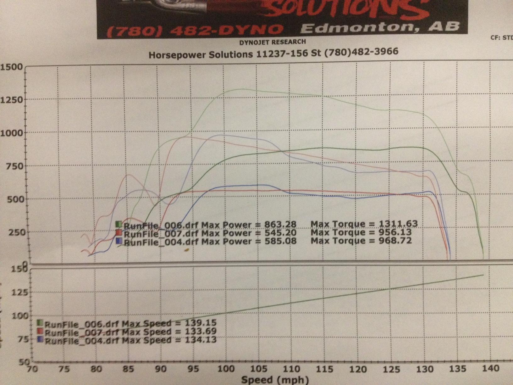

545 extreme street
585 extreme x
863 bottle baby
You can see on the graph that as soon as I let go of the brake the power drops off, that's becuase this dyno has no load brake, so we sere starting the run at 25psi at peak hp and dropping to 15-18psi by the end of the run. This is half the reason james truck gain so much on spray. When we sprayed it, the truck maintained max boost of 32psi for the whole pull. Can't wait to run on a load cell dyno in the new year. Hope this makes sence. If it doesn't I'll try and explain it better.

I know everyone pm's and Shawn's comments of not to worry about a non load cell Dyno #! It is what we had available at the time but I honestly am not concerned with the #.
The "Street Toy" status is achieved in my books! I of coarse will still do the other tests I promised, but I will wait till spring to afford another day at the Dyno. Maybe adrian will be in the position to throw his stage 4 in the mix as I would love to see back to back same day tests with all three turbos.
I think with the big sticks Shawn built I can use more air to achieve higher numbers! But do not want to sacrifice drivability!
This girl has done over a 1000 miles since the fluids went in, had a Day at the Dyno, layed down some respectable numbers on various files of 545 and 575 then Layed a smack of a number on the juice (863) hell yeah! Plus a little winter field fun and then pulled my other truck and trailer back home a few hundred miles!
