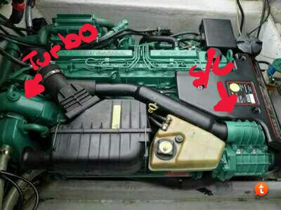

They've been doing turbo supercharger set ups for years on boats. The supercharger has a clutch on it like a/c compressor. Then there is a check valve on the air box. Might not look cool but it works well. Supercharger. For low end to spool turbo then when a certain boost is reached supercharger shuts off and turbo takes over.
