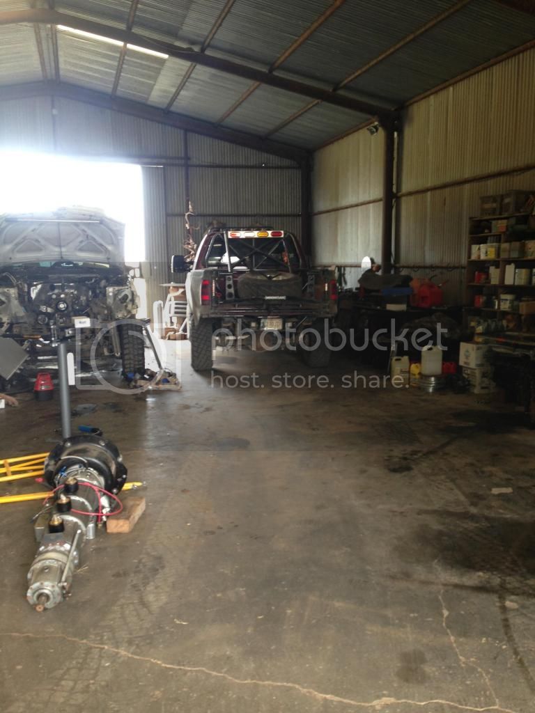

Well it has been pulled into its hole for the next few months (probably more lets be honest :( ) starting tare down soon.
Cutting-Edge Diesel
Feb 10, 2012
5,738
Newkirk, OK
4 link rear
Engine cage
2.5 coil overs
3.0 4 tube bypasses
New compound set up (if I can get it to fit)
New head gaskets
Custom age studs.
Full interior cage
Suspensions seats
Etc

Twin traction beam all day son..........don't see why you couldn't make the mounting points from a two wheel drive super duty work with the mounting points of a 4WD TTB axle
Cutting-Edge Diesel
Feb 10, 2012
5,738
Newkirk, OK
Have an idea I may see if it will work.
Making a dry sump set up for the motor and move it back and down to move weight back and a custom crossmember to allow the axle to go up more.
