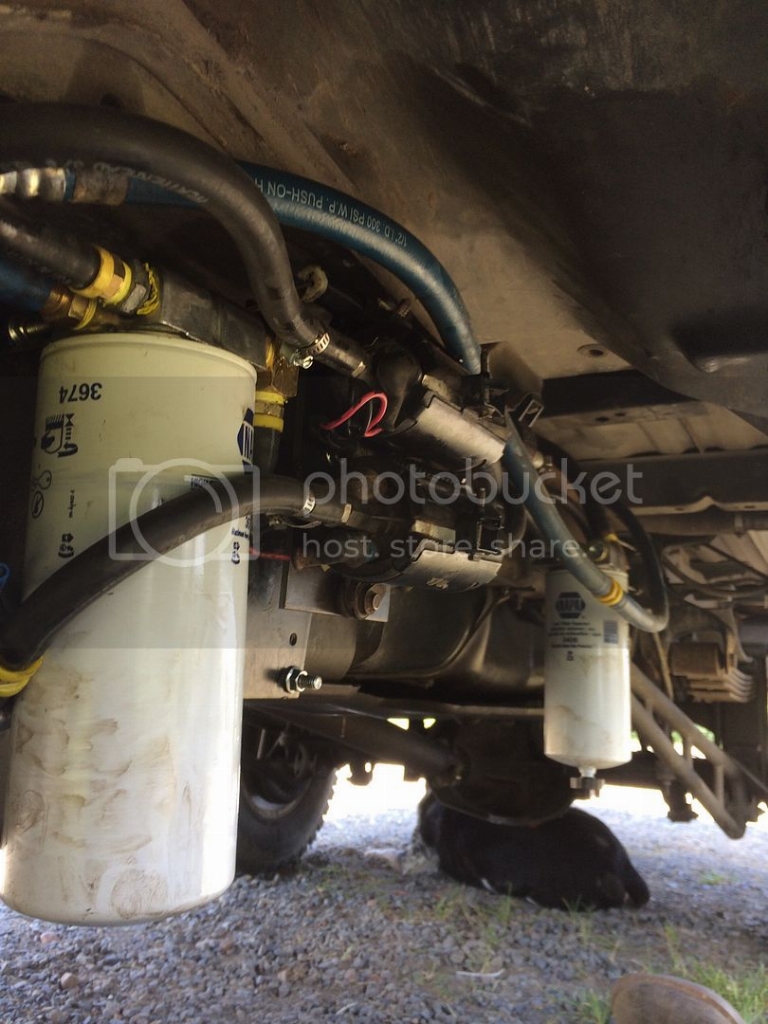

Well I already have a regulated return and intake mods so all I really want is the pump and filters?

That's why I went with the Napa filters and bases.

I believe it's a motor/pump failure. Due to the fact that our engines require 60+ psi to operate efficiently.

I currently have a Fass system and will be changing it out due to the negative feedback. My pump is young and no issues but would like to avoid injector damage and a roadside breakdown.

Is it all the AirDog pumps? I have the newer AirDog II DF-165 GPH with adjustable pressure regulator. The install instructions claimed it was preset to 50-55 lbs. But I never checked it. Guess its time to take some pressure readings. I have made some mods to the fueling system, Bottom sump, Regulated return and some fuel bowl mods to improve flow restrictions. I'd hate to have wasted 800 bucks.

Im not saying its going to fail. But there track record hasn't been that great. And you might want to check your fuel pressure as you mentioned.
