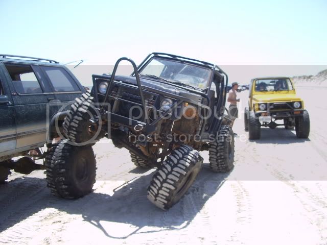

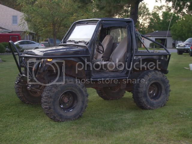

My old zuk. 4.3 Vortec, T350, Toyota axles, 5:1 t case gears.
imelmo
6,633
That's pretty sweet lookin'. How hard was the engine swap?
Powersmoker
648
Chesapeake, Va
It wasn't too bad really. I had to fabricate engine and transmission mounts and had to modify / widen the transmission tunnel. Kinda time consuming, but not hard.
