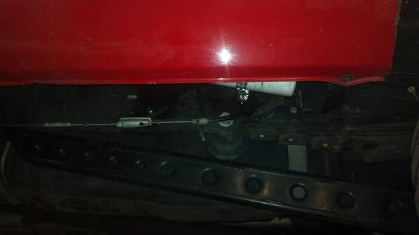

my favorite bottle location. could not see it.
Wayne
2,540
8
Twin Falls, Idaho
I was laying on the ground when I took this pic. Bed front inner fenders are in now, and they completely protect/hide the bottle unless a tire chucks a rock at it while backing up.
The other night, when I lost the data, I got mad, and decided to work on something else. I ended up tapping into the signals for RPM, MPH, MAP, and TPS for the nitrous controller. It's now fully wired & plumbed except for the power switch. My wiring harness just showed up today for the upfitter switches I'm adding to the truck, so the Juice will be ready next time I hit the dyno. :redspotdance:
