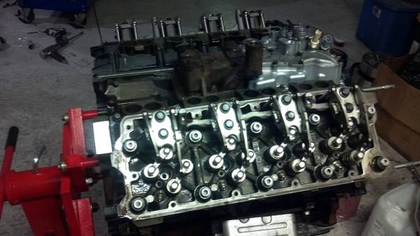

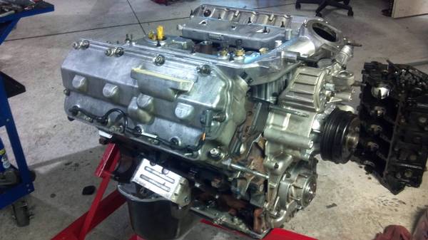

^^^Well, here's where I left it saturday night
^^^and here's where it's at now. With any luck, and a late night, I might have it running before I leave today. ...maybe
