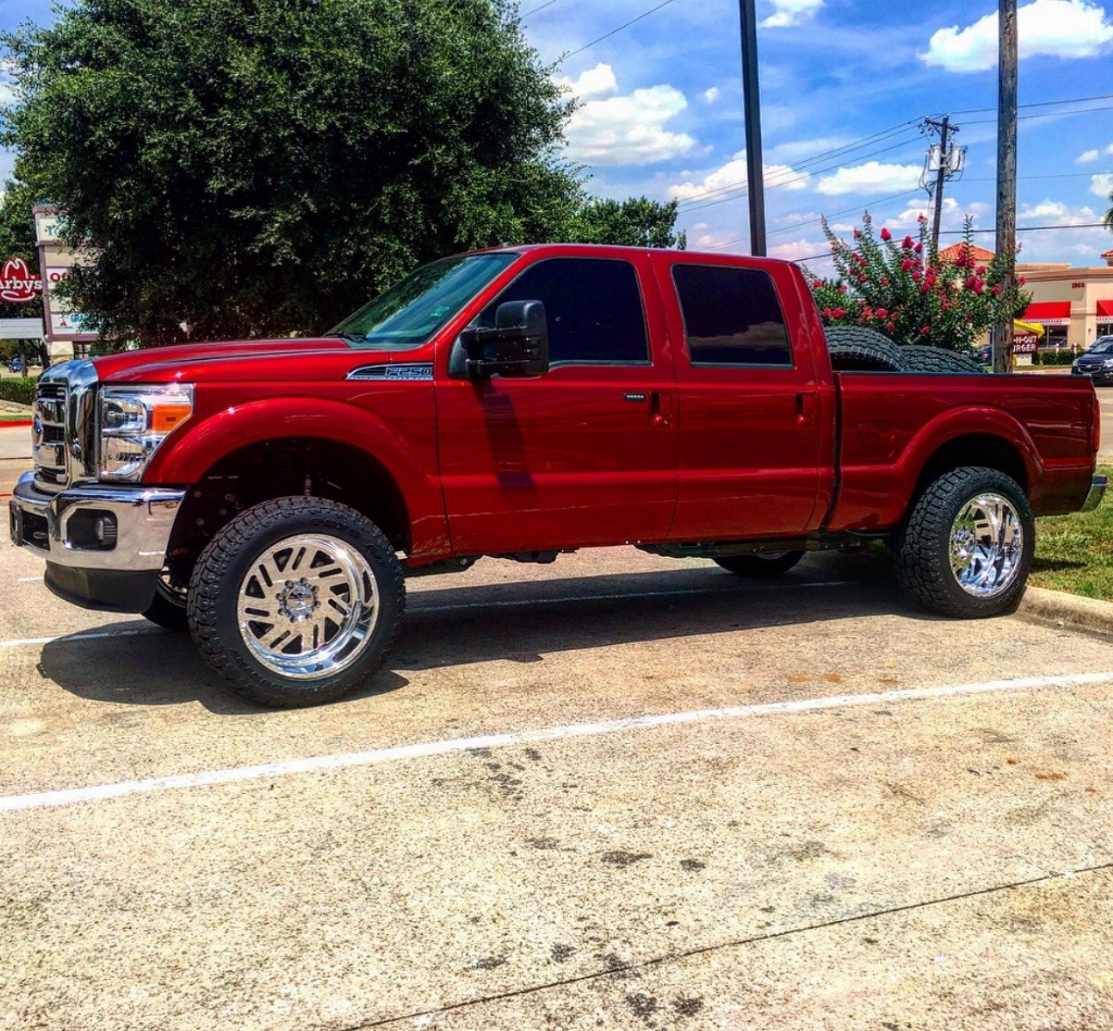

What size wheels and tires redracer?
Looks great but that front must rub like crazy.2016 F250
Icon 2.5 coils
Fox 2.0 shocks
Carli adjustable track bar
American force shift 22x12
Toyo AT2 325/50r22
I run the same tires on 10.5" wheels and had to go 3" up front plus shimming and trimming.

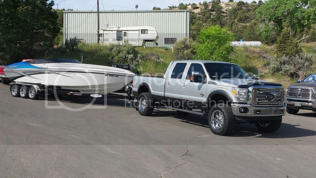

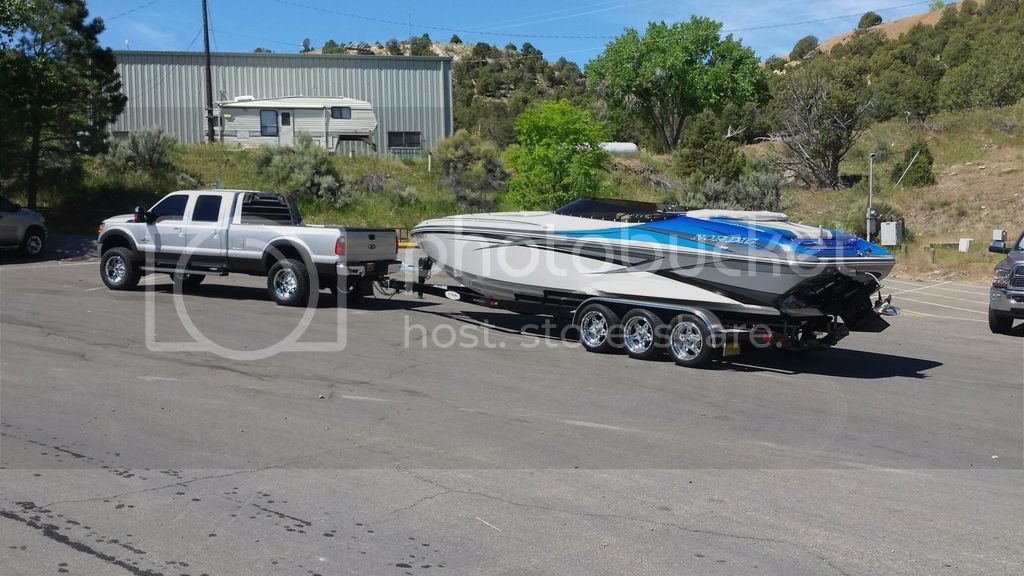

Here's my 2016 F-350 with the Ready Lift SST 3.5" Front / 1" Rear. The tires are 325-60-20 BFG KO2's on RBP 20x10 (0 offset) wheels. I also installed the Air Lift 5000 air bags with the wireless controller compressor kit used when towing.

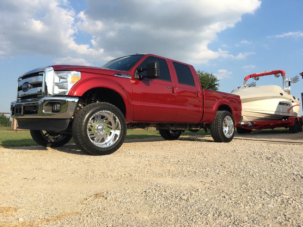

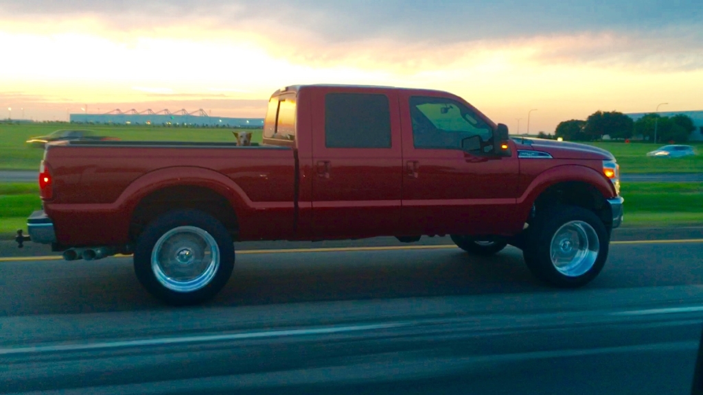

Got any more pictures. I'm looking at the same set up!
Damn I'm jealous. Lol
Only other pictures I have as of right now are of when we did the lift lol
And of getting ready for the 4th
I'm sold!!22x12 and 35's all day! Great looking truck man!!
