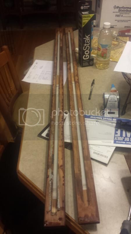

I put 2 coats of polyurethane on all the wood trim. Debating whether or not to do 3 coats for a more smooth finish.

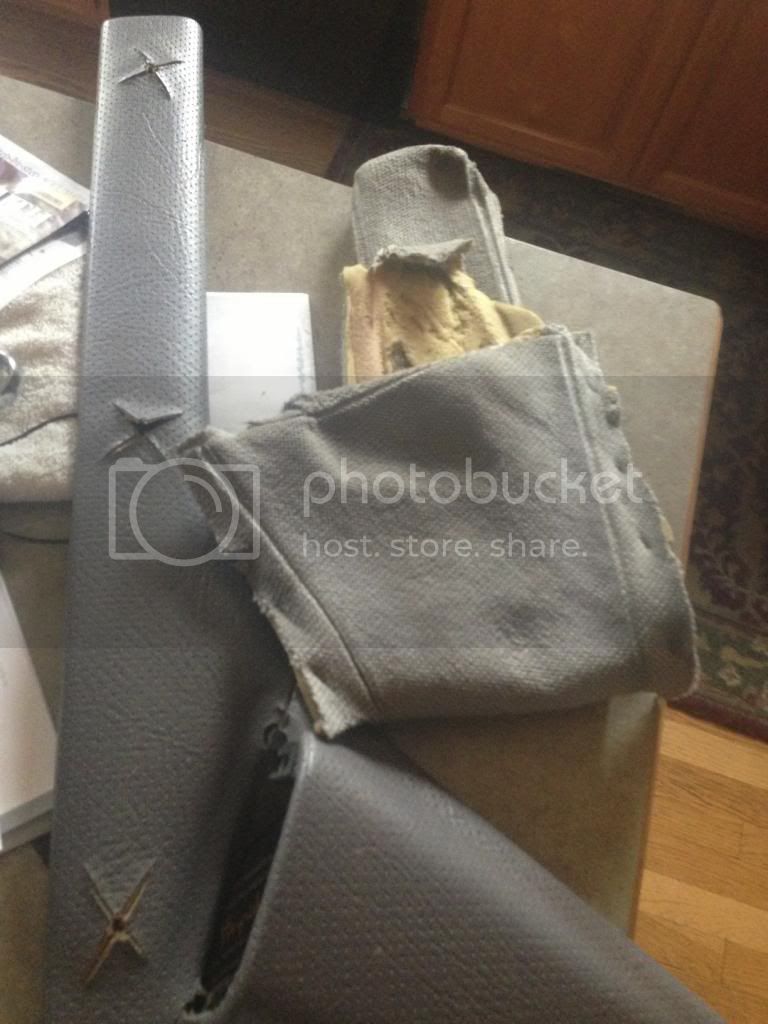

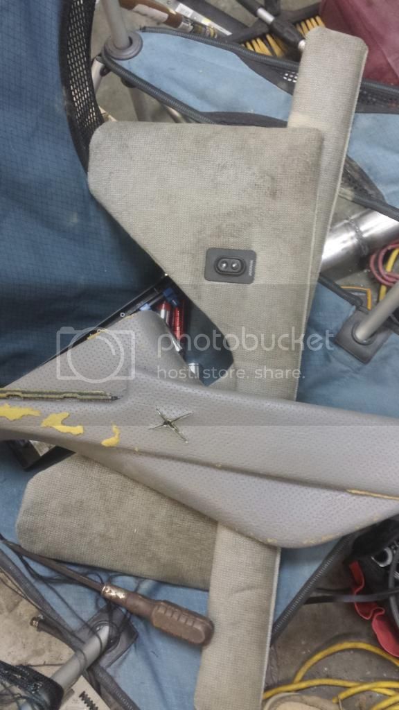

Pulled out all these door panel inserts. I am stripping off the nasty cloth and re-upholstering it with some vinyl.

Now that the polyurethane on the wood has had 72 hours to dry, I began working on it.

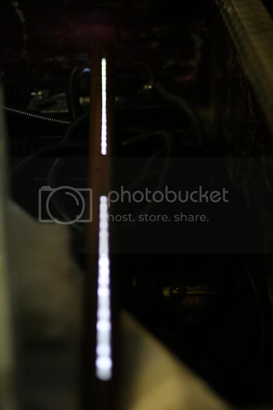

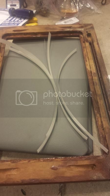

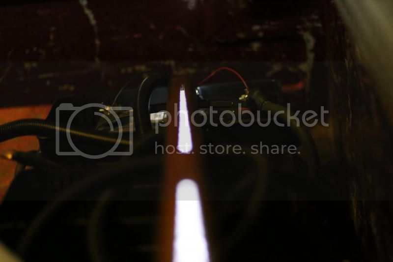

The wood that screwed into the headliner had old ghetto rigged rope lighting in it. I pulled all the old rope lighting out and bought some 12v 3/8" rope light.
I also bought a sheet of acrylic diffuser. I cut the sheet into slivers and glued them into the channels of the wood. This gives the rope light a more even and softer dispersion of light.

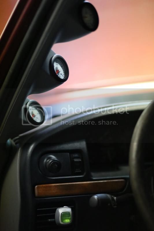

Gauges painted to match:

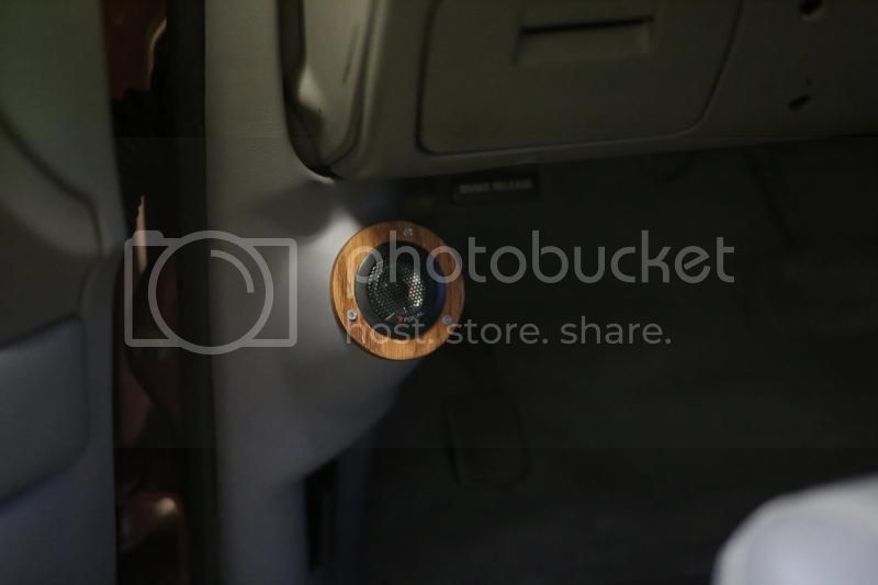

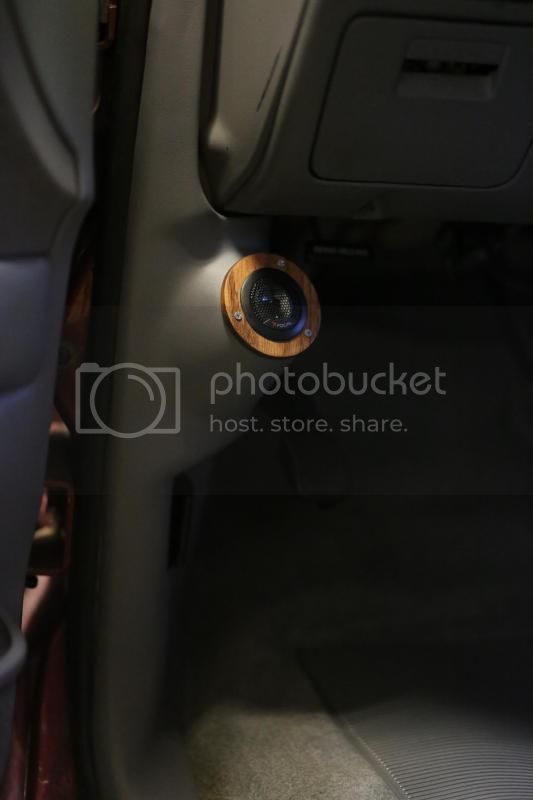

Finished shots of the kick panel tweeter pods:

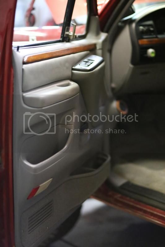

I also put the door panels back together. I got the vinyl inserts back from the upholstery shop. They look great, but not 100% happy with them. If you look closely at the door panel insert, you will see a body clip pushing out on the vinyl. The upholstery shop claimed these would go away with time, I have a hard time believing that..

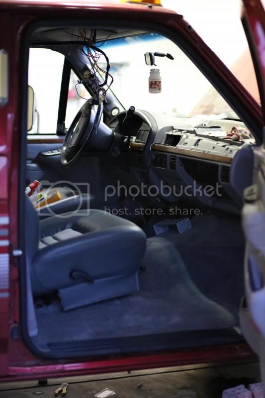

Anyways, don't be fooled by the above glamour shots. The interior is still a mess:

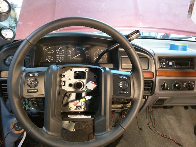

Got the new shifter lever & boot installed today (the old one was cracked). Also got the Airbag assembly in place. Steering wheel is looking much better! Next task is to begin modifying the old steering column plastics.

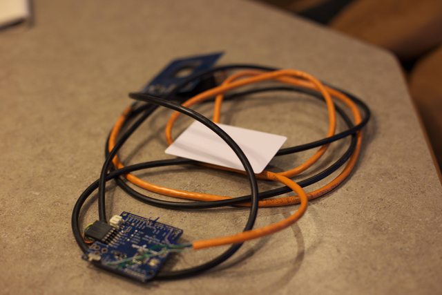

Another work in progress... Arduino and Parallax RFID Reader. This is my future ignition switch. Swipe RFID to turn on ignition, swipe RFID to turn off ignition.

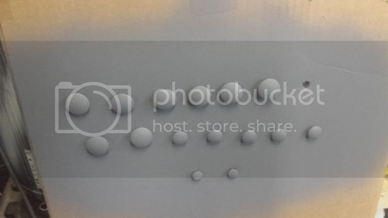

Doing some modeling for the overhead center console, a new switch plate. It's about time to turn on the CNC machine again.

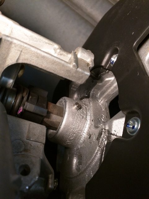

I went to the junkyard and pulled a few steering columns apart. Harvested some steering shafts. I have 2 stock shafts left if you want to purchase, them!
I used a metal planer to do the machining, then I mounted the steering shaft in an indexing three-jaw chuck, I set it to rotate 60 degrees - 6 times, resulting in a hexagon. This took me about 2 hours to get everything set-up and machined.
After I had the shaft machined, I did a test fit. After the test fit, I pressed in a taper pin as a safety measure. Originally I wanted to have an entire shaft machined. Unfortunately I couldn't find a shop willing, due to liability.
