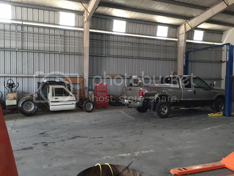

Donor truck has arrived. :D
Should start pulling the bed and cab this weekend.

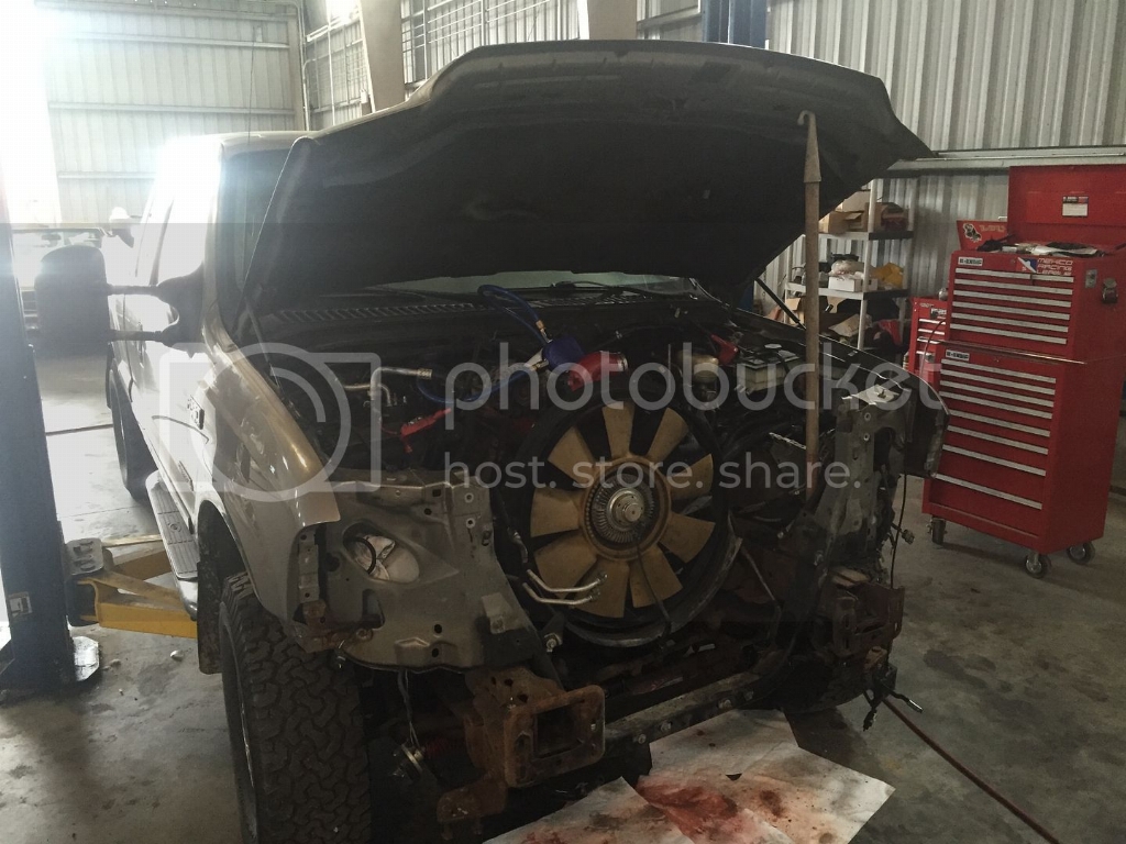

Started tearing the donor truck down. This thing was quite obviously in a bad wreck at some point and someone hacked it all together trying to get it on the road. Good thing the guy sold it to me and not someone that was actually planning to drive it. The engine runs like a champ though.
Got about another hour of work to do and the cab will be off.

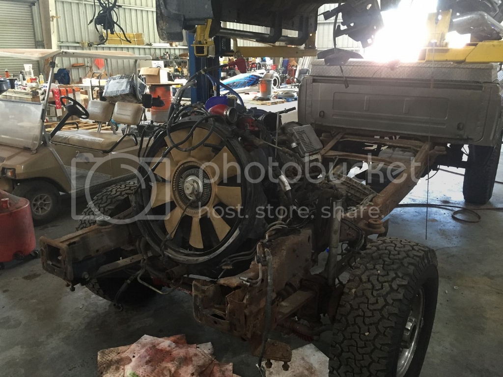

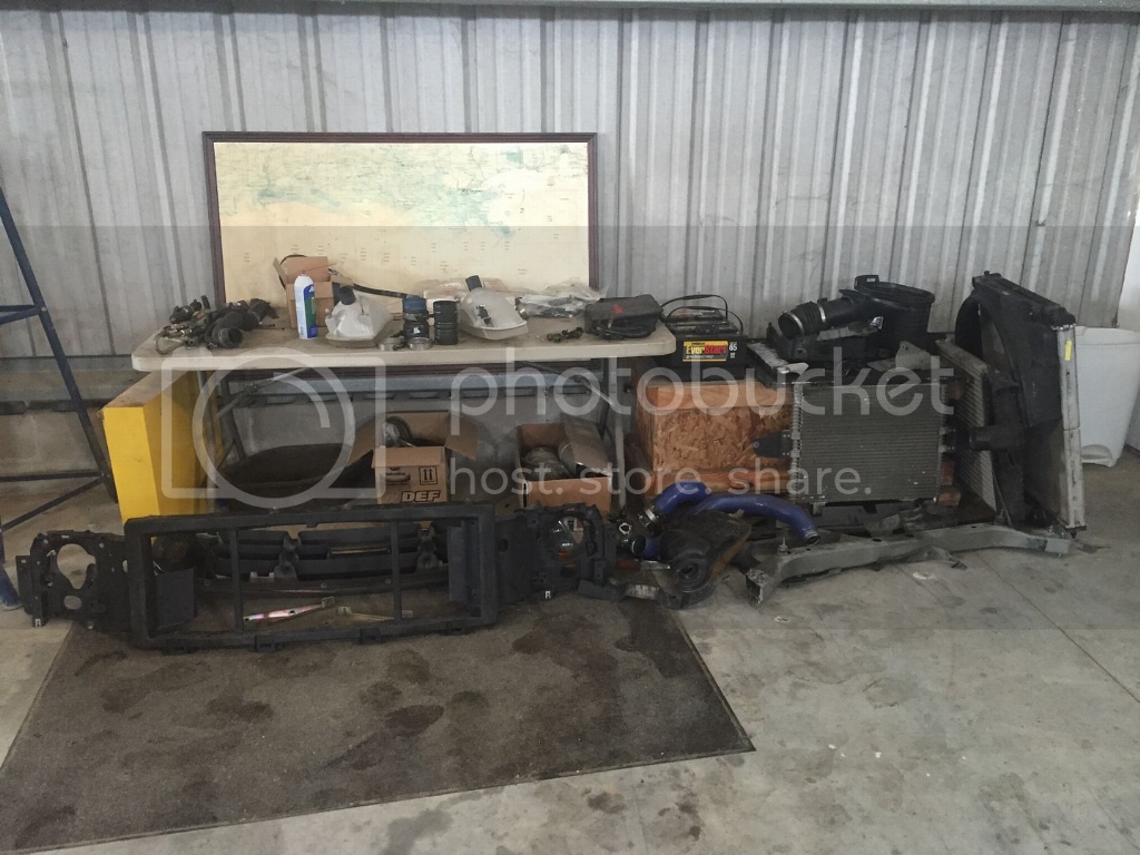

The engine is out of it's nest. :D Gonna see about building a stand for it now and start messing with the wiring next weekend. I have no idea what harnesses and stuff I need and I've never pulled an F250 dash so this should be interesting, lol.
