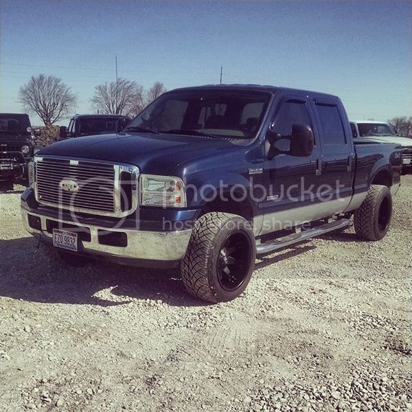

Well guys here is the latest and greatest update.. The Stage 3 and the 155s do play well together, however a little laggy in the bottom end. Definitely in need of a fuel system and bigger injectors to see the full potential of the new turbo. Looking at 205/75 or 190/75 So any sponsors who want to throw those my way feel free I wont object..hah:D
The Toops Stage 2 5r110 is awesome, Bryan did a killer job with that. I'm still having some tuning issues that may be causing her to run a tad on the hot side. But Matt is working to resolve that issue for me. I initially wanted to lower it some but undecided at this point.
Over all really impressed with the build to this point.
Here is a shot on the lot of Mink Enterprises...lol
