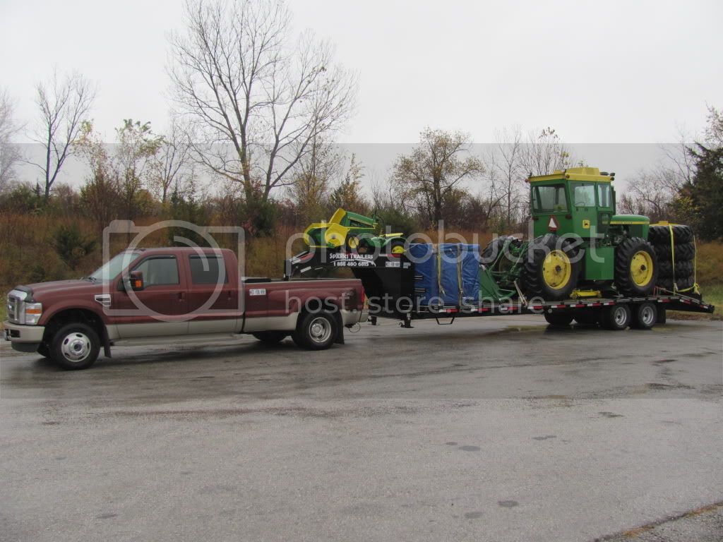

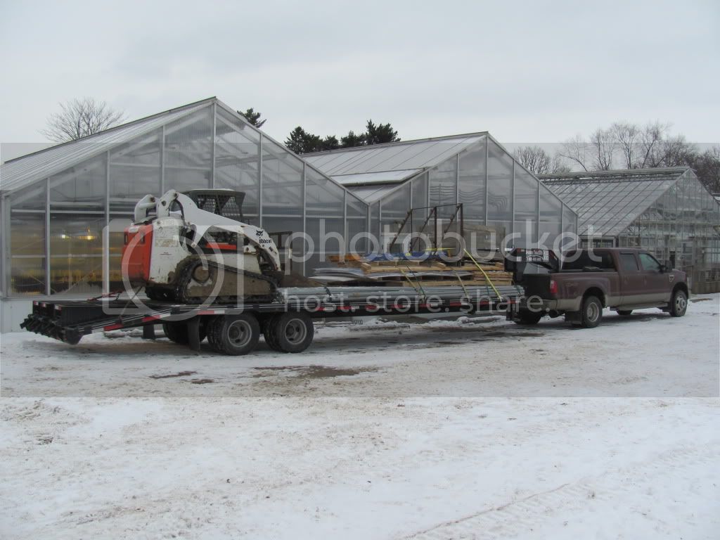

Had the same issue towing real heavy 5 years ago before my lift. Haven't towed since I put the OUO's on but noticed a difference even empty. Especially on washboard dirt roads, backend stays planted. I'll see if I can find a picture.
Sahrens0202
May 30, 2011
310
OH,WY,ND,CO
Happened with this load. Only went about 100ml.If I remember the Bobcat is a T190.
And this one..
And this..
Especially this one.
Went from NW Kansas to Nashville on the spartan 210tow and had to get on it or take off really light for it not to shake the truck apart. It was horrible. Grossed 39k and change.
