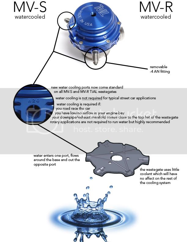

So far the gate is working really well. It hasn't been on very long but so far no issues with it at all. I really like how tial sets there springs up versus what precision does. They have alot more options on springs for dialing in your spring pressure in the gate, and are all around easier to setup.
i know that the v band clamp was slightly modified to mount the precision gates.
are you reusing the old hardware (v band) or new?
There is no difference between how the precision mounts and the tial. The tial will go right in place of the precision.
So.... how exactly will these be hooked up then? Small hose coming from...?
I tee'd off the small coolant line going into the side of the degas bottle to route coolant to it.

Mike has the special fittings needed to clear the cowel

Thanks mike.. That was really all i could visualize, but I dodnt know if enough coolant would move through it to make it worth it.
Erikclaw
4,877
Central CA
It doesn't need a lot of flow, I am pretty sure the passages are small. That flow is enough for the coolant filter kits.

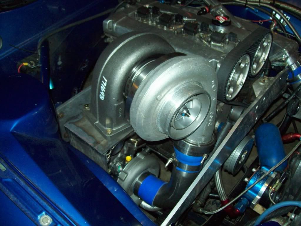

I used to run Tial wastgates on my EVO and my 96 GSX Eclipse. I never had one fail and they were mounted right on the manifold. Yes a gasser and ricer but 40 psi is 40 psi. I believe the Precision Turbo took Tail's design and made their own. Do not quote me on that but look at the pictures and see for your self. Tial has been around for a many of years.
This is exactly where my experience is limited to! I have a95 GSX that was running huge injectors and huge turbo and Tial wastegates are the norm and they HOLD. There were some others around back then and they were cheaper but couldnt take the heat coming off the tubular manifolds with t4 chargers mounted directly on them. 40 PSI? I never got boost up that high in mine. I know a little more now and am going to rebuild my GSX to hold 65lbs of boost! Ill pm ya shipmate when I get that ball rollin and tell ya what I find out.
Shipmate
271
WA.
C16 and GT35R and a Magnus 4G63 FTW!
TyCorr
Jun 23, 2011
15,461
Im going to have Buschur build me a longblock that ditches the balance shaft. Carillo bottom end and some custom cams. You can do so much more NOW than you could five years ago with those motors. And the F&F bs wore off and its affordable again. My 95 hasnt been licensed since 05. Its gonna get built and Im gonna put 1000cc inj's and gt42r...hopefully run e85 so I can run higher boost #'s. Im not sure I know what a C16is?

These gates are a little tricky to plumb. I ordered everythign for shones truck thinking they'd be 1/8th inch-Wrong... The gates come with water ports tapped 1/16NPT and adapters that are 1/16- -4AN. For shone's, I'm using all -4 Steel Braided stainless lines. I'm pulling coolant from the EGR delete plugs and running the lines up along the intake mani to the gate. For the top port there is very very little room to work with. I've been working on building a custom banjo fitting that we got as a weldon fitting that I'm going to weld a -4AN bung onto and hope that it clears the cab.
The only draw back to the Tial gate that I've found is that you cannot rotate the top section of the gate to move the ports to a more convienent location.
