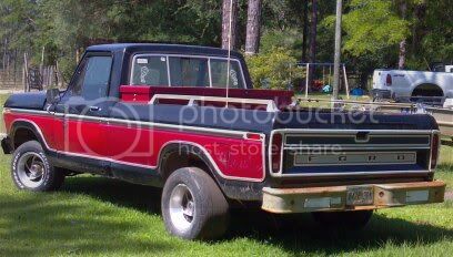

This is the only pic I have of it on this pc, she is dirty. Dont make fun of the razor wheels and the calvin peeing on a bowtie stickers, they were cool when I was in school...lol. I am gonna restore her again oneday, she has held up good so far I painted it in highschool94 or 95. She a beast 9.20s in the 1/8...lol.
sorry for the derail, he asked, its his fault!
