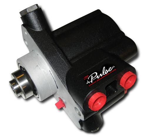

Bigger is not an option for the original housings than what is currently on market.
We've been down this road before and so have others...
It's not shelved for good but it's definitely not possible in its current design.
Here's another fun one:
Also not shelved for good but shelved for now. Transmissions took charge.
