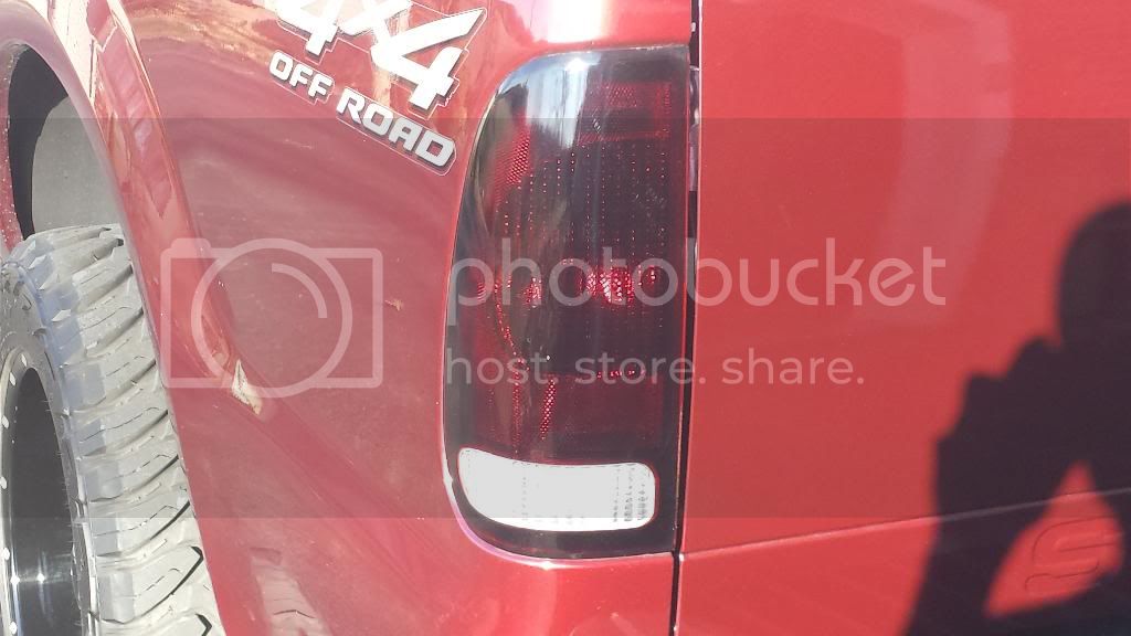

Heres a couple pics of mine done with vht nite shades
