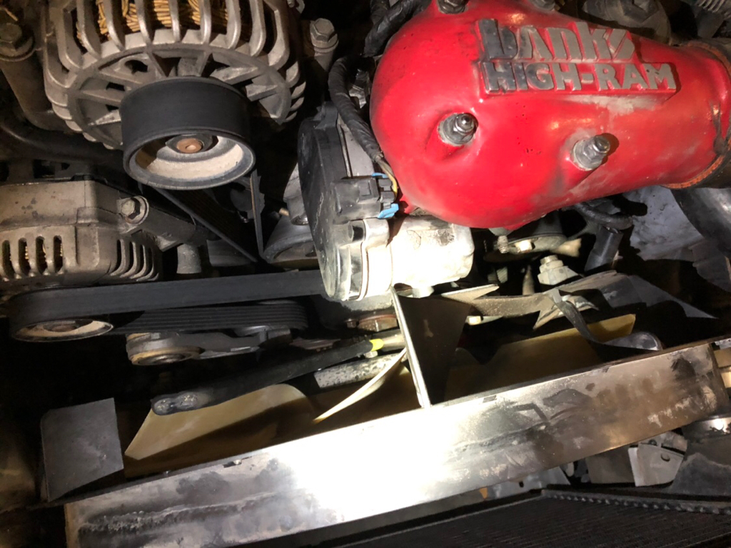

I’m having trouble loosening the fan to remove it to access the water pump. I’ve watched DTR, but don’t have an air hammer. I’ve seen a number of other vids which all use the trick of working with the belt on and placing something long into the hole on the fan pulley.
I’m seeing 2 things which seem to differ from the vids for me. 1) I’ve got a Banks High-Ram in the way so I can’t go straight down. 2) the cover with the slits in it turns when I turn the fan, and I can’t seem to find a way to slide something into it and force it to stop—what exactly is it supposed to be catching on?
Any tips? I’ve already got the air filter, shroud, and radiator out. I’ve also removed the bolts on the diffuser/rear shroud so I can pull it right next to the fan.
Thanks!

Well, I tried the air hammer thing and got a bunch of impact marks in the nut. I worry that there’s just way too much rust in there. The pulley directly below has a bunch or rust, and the undercarriage has a ton of rust. I’ve also tried a crescent wrench and a sledge hammer. Nothing seems to break it loose so far. I haven’t ordered the wrench set from Amazon linked above since it’s over $100...does the air hammer and chisel normally tear up the edge like that? Or does it usually give and turn before then?
Should I be looking to see if something else is broken on the assembly?

Maybe. I don’t mind hitting it hard; I just don’t know how to tell the difference between what’s gonna damage it and what will make it turn. Stuff I’ve seen online like DTR’s vid has warnings about too much, but I haven’t seen a pic from anyone who’s used an air hammer and chisel to turn it so I just don’t have a decent idea of how much is too much.

I’ve got a pulley holder from them at the moment. Their fan clutch wrench set didn’t seem to have the right size, but my crescent is big enough to fit on it, and so I assume that should be ok. Are you thinking a longer handle or a perfectly tight fit will do the trick?
