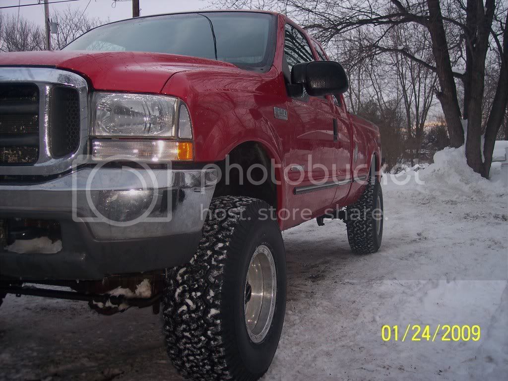

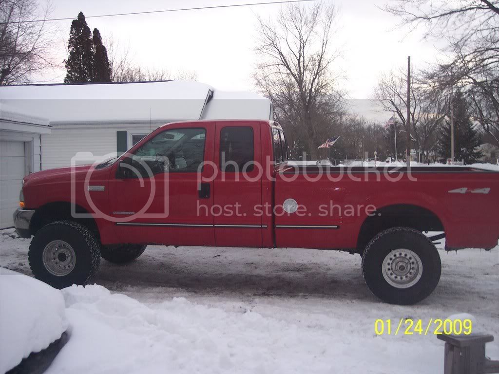

Here is about the only good pic I have of that setup. 4.5in backspace 16.5x9.5 wide rims and 35's with 2in leveling kit.

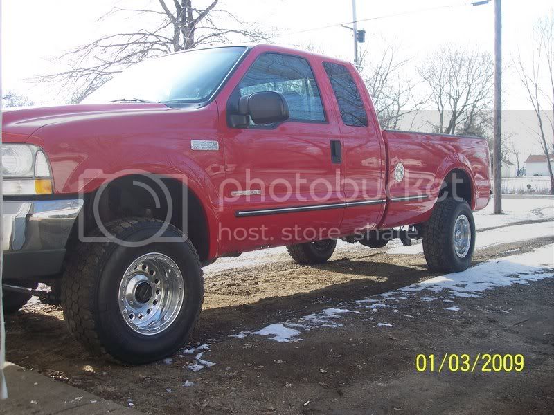

Same setup but 33's

Me personally I liked the 33's look more since they didn't look stuffed and they didn't rub like the 35's did.

Thanks chappy that is the look i am going for. Perfect. So when turning with a 4.5 backspacing the 35s dont rub the spring?. I was going to trim the plastic on the bottom of the front bump and tie back some of the wheel well cowl if it rubs. Im more concerned about rubbing on the springs.

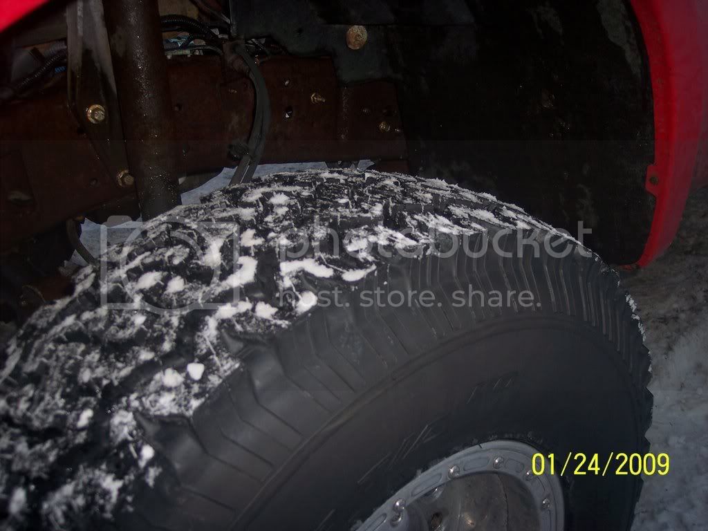

Never touched the springs after an alignment. At first the drag link was off after the lift and turned more one way then the other so it rubbed when truning left I think. After it was ceneterd it never rubbed again on the springs. I also had to trim some plastic and pull back the inner fender . I drilled some small holes and used a few zip ties. It rubbed pretty good at te bottom of the inner fender till I pulled it back. No damage just sounded bad.
