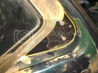

Alright gents what you have all been waiting for!
glovemeister
Nov 17, 2011
138
I went around the edge and went slow and tack welded the corners and a few more in between. I didn't up the paint really at all. The mirror overhang covers most of that and then the weatherstrip or windshield sealant I use to seal it up tight will let you see none of that.

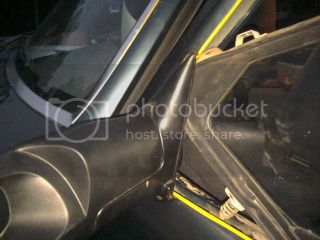

Inside view with mirror mounted
