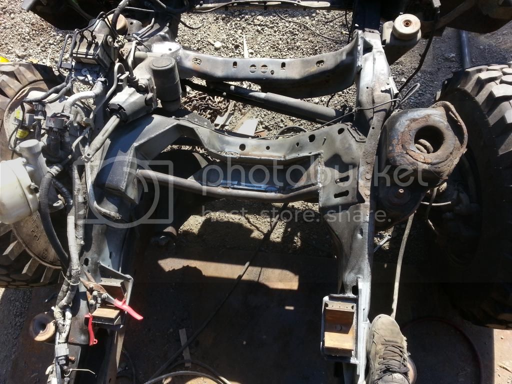

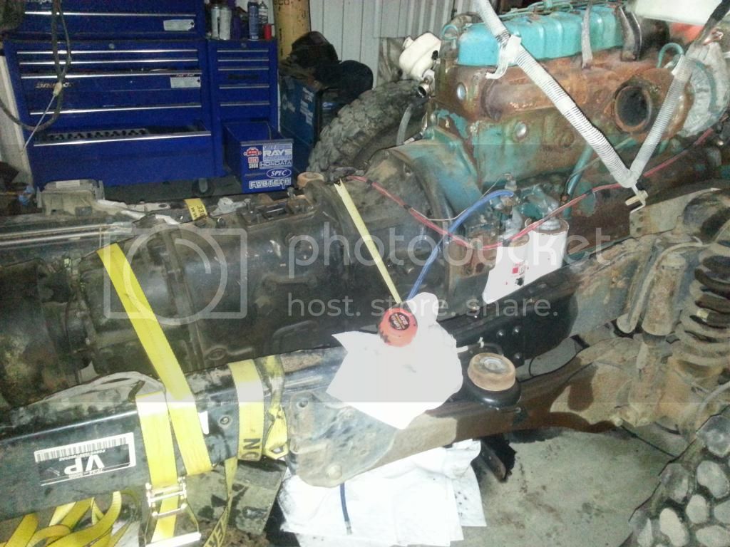

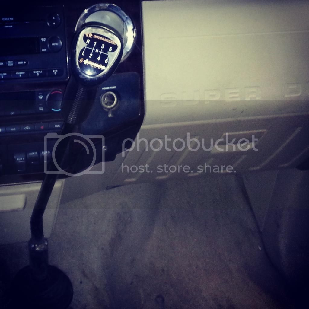

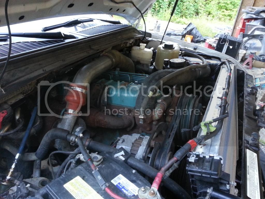

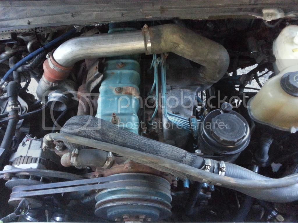

Was googling some DT360 stuff and came across this thread... I'm just finishing up my DT swap in an 08 F450. ;)

Yup, this is phase one...get it in and working so nothing is pretty yet. Just functioning.
