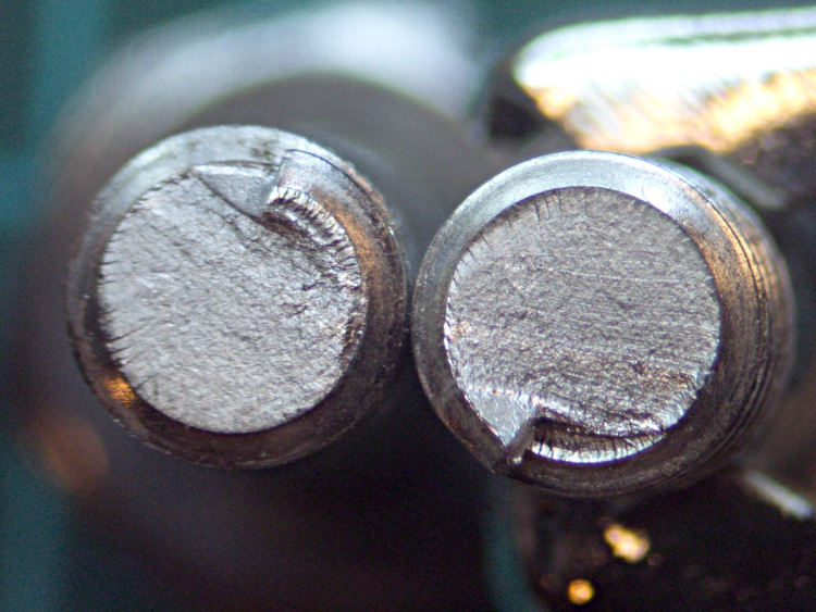

Of the failures you have seen, its probably safe to assume the bolt typically fails towards the bottom of, or below the link bar itself? (between the joint and the mount on the axle)
Secondly, the now separated bolt probably has a flat portion (probably less than 50% and then the rest has a "streched" look ?
Similar to this, which is showing a mostly sheared failure.
