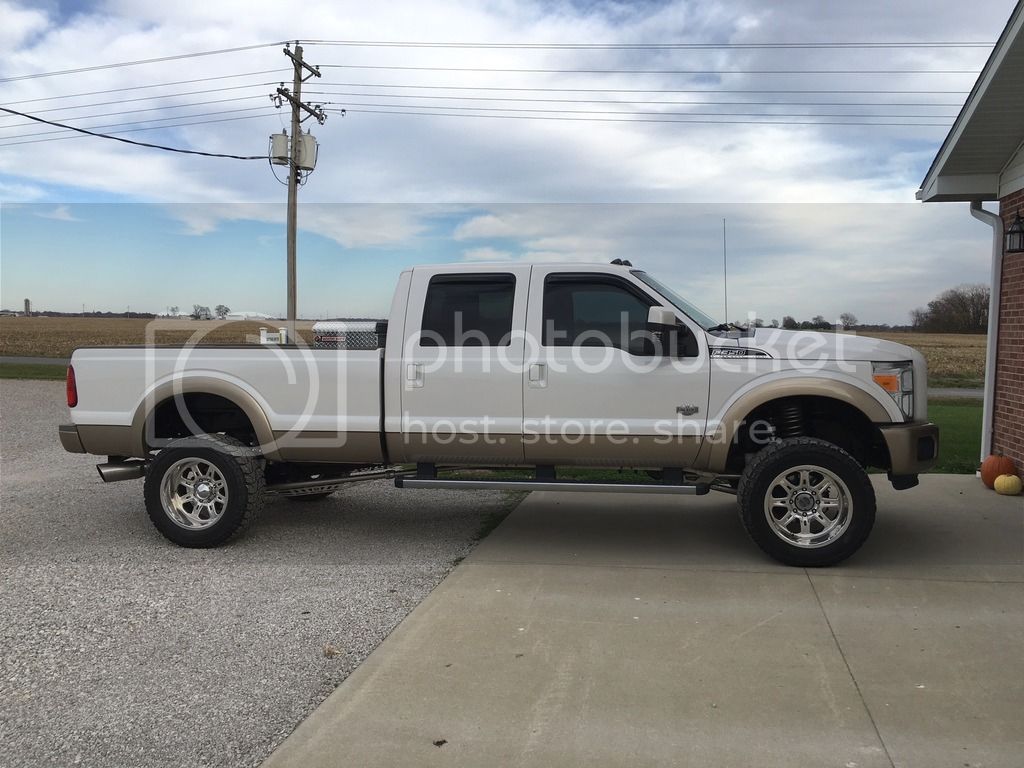

ptm'd OUO long gusset bars and ALA's :toast: Jared, aka breaking habits on here will hook you up with what ever you need
I have a crush on this truck. It looks SOOO good.

Your truck looks awesome too Pete, and yours is WAY faster lol (no offense WHY NOT)
But those PTM suspension parts and the weld wheels...Mhmmmm :drool:
