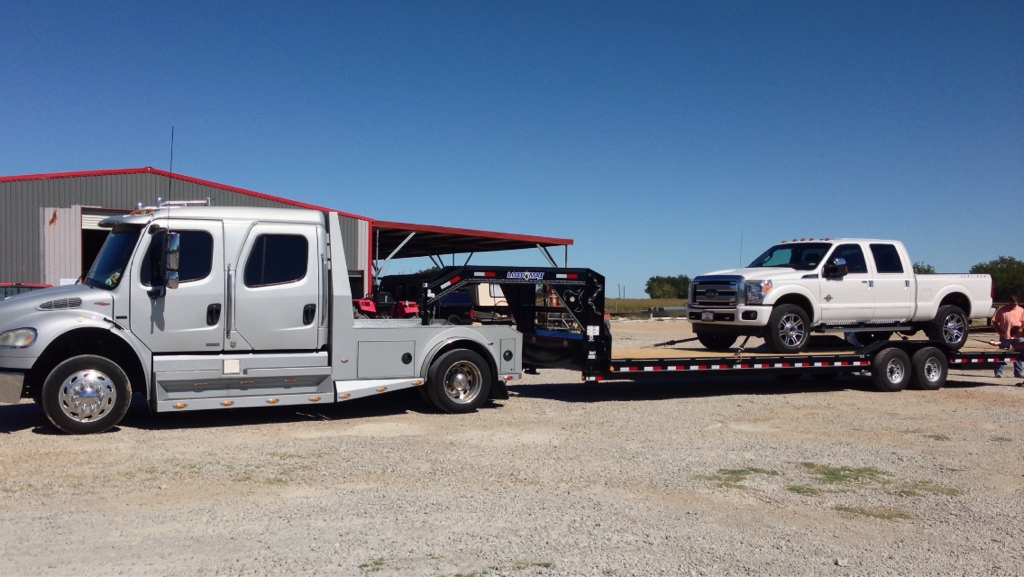

Payed close to 11k for our 25+5 PJ deckover. 2-7k singles, Hydraulic jacks, hydraulic over electric brakes, torsion axles, monster ramps, and strap rails. If they offered anything longer I'd have gone for that. Even at 30ft it can be a bit small at times. If you use your trailer often, and want a well built trailer that won't have electric problems all the time, the price isn't all that bad

Couple things if you are set on a deck over such as the ones you linked. Get the lowest possible deck height.
4 tires against the road is more resistance, less mpg, more upkeep if you don't need it.
If you are only carrying your truck or cars I don't see the need for a deck over with 2 10k axles. It is also a huge pain to load low cars/trucks on deck over trailers.
They have their place for sure, but hauling cars/trucks all the time isn't one IMO.
Only time we use a deck over is when hauling equipment.
