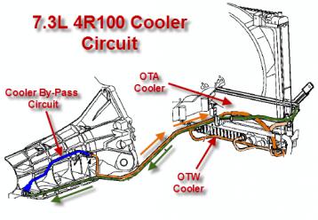

Here is a diagram.
Rusty

Question about the radiator flow. I skipped mine thinking i want the cleanest possible with a new trans. Whats the benefit?

It is where the majority of the heat is removed. The air cooler would have to be many times larger to keep up with what the cooler in the radiator can do.

Not going through the radiator?
Don't bypass the radiator cooler.

Totally understand your thinking but the rad cooler is very important especially when in reverse. If your trans had a catastrophic failure, you need to replace the trans cooler in the rad but it's easier to replace the entire rad.

Understandable I'll reroute i was little bit worried about the transmission warming up

Ok thanks. Makes sense now. It's on the todo list asap
