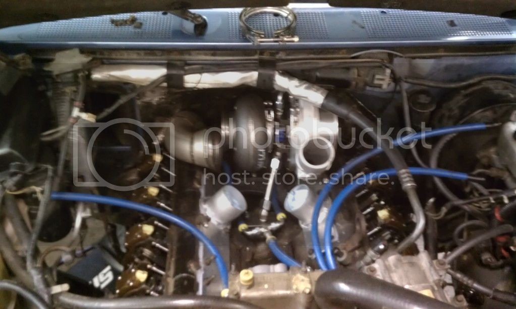

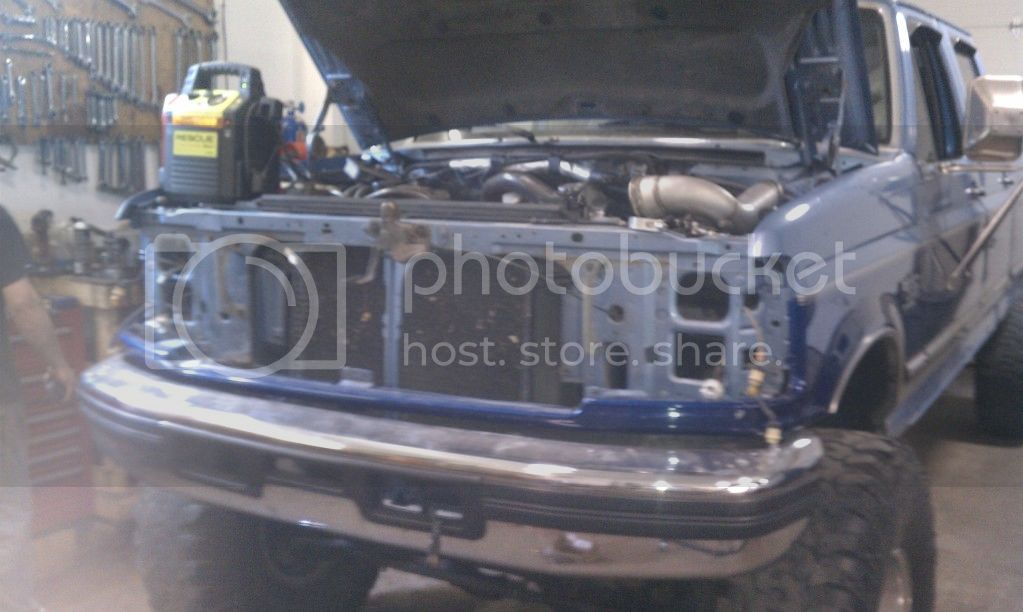

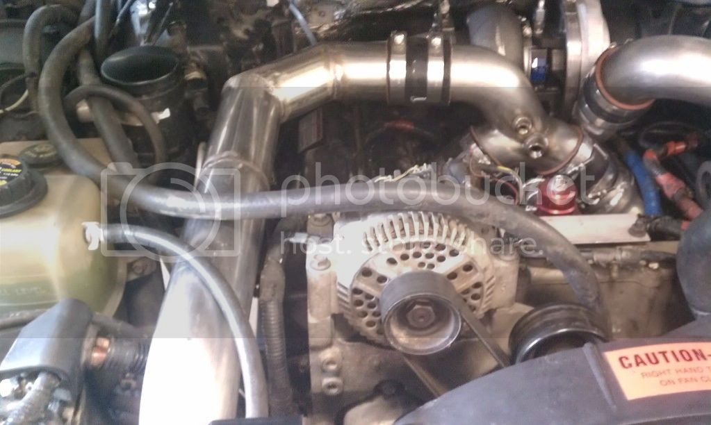

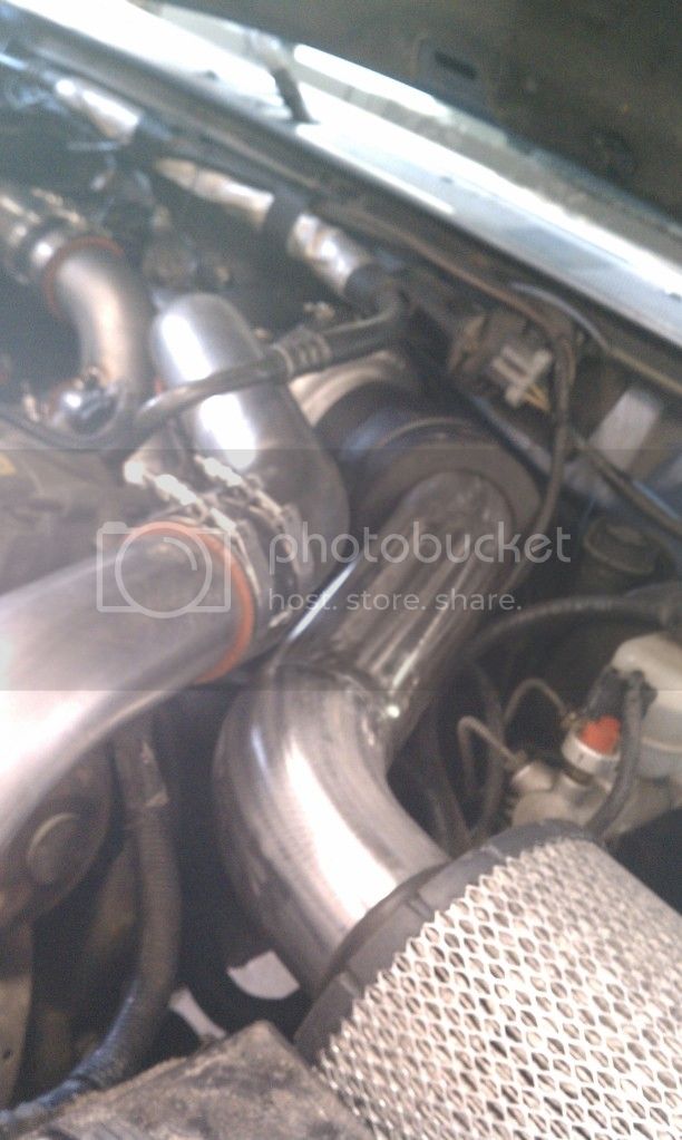

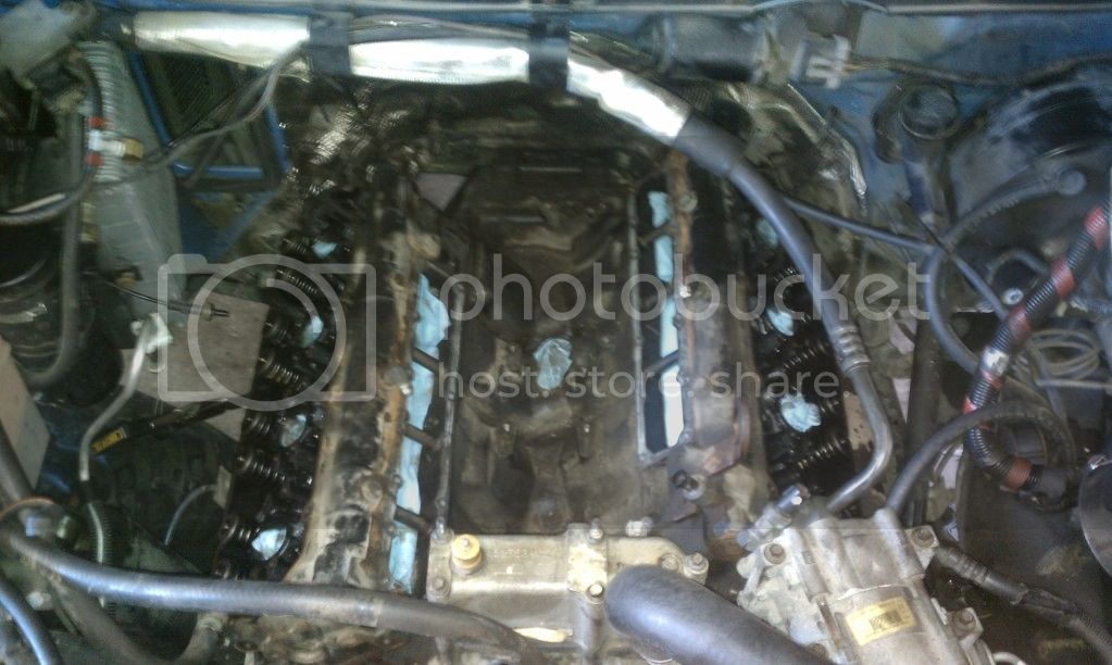

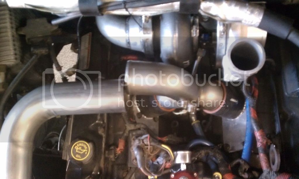

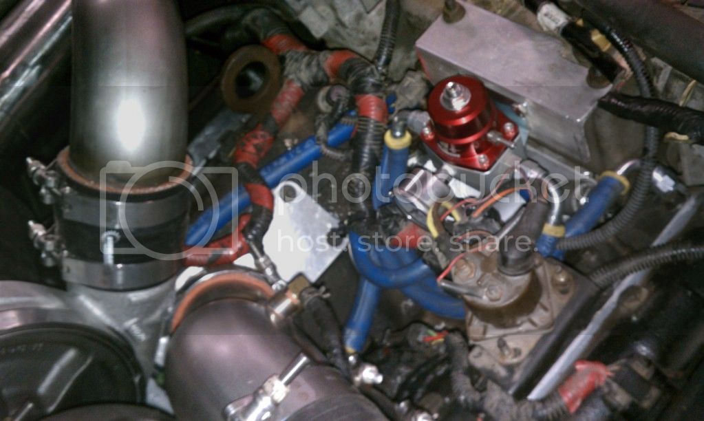

Got started with a fury. Everything fought us all along the way LOL but we are almost there.
Got her fixed up.
This engine sat pretty far back, could not even get the stock uppipes out without rocking the engine! Getting the Irate kit on was a bear but we did it. Spent a few hours massaging the firewall and then ended up having to clearance it for the downpipe. Installed new tank, but then 5" exhaust was in the way LOL. The intake y didn't quite line up with the intercooler tube so we changed her a little, we made an intake for the race cover. The CCV was too much in the way so we had to swap valve covers. Looking at welding a new oil filter onto the valve cover so we don't have to pull the intake to change the oil. This might be something we start doing on all of the Irate kits....... I have 4 of them to do it to :doh:. Umm I'm pretty sure that's about all for now. We plan to test drive the truck today since the CCV stuff is here to replace it. So far it's being a typical OBS LOL trying to fit 10lbs of **** in a 5lbs bag.
Will keep you updated.

After just installing a S468 on my truck, I think I'd charge about $5k for labor. It was a bitch, but mine was a superduty also. Couldn't imagine an OBS.
I was able to run a 5" intake on my truck without swapping the valve covers, but I've got mad skills.... :hammer:

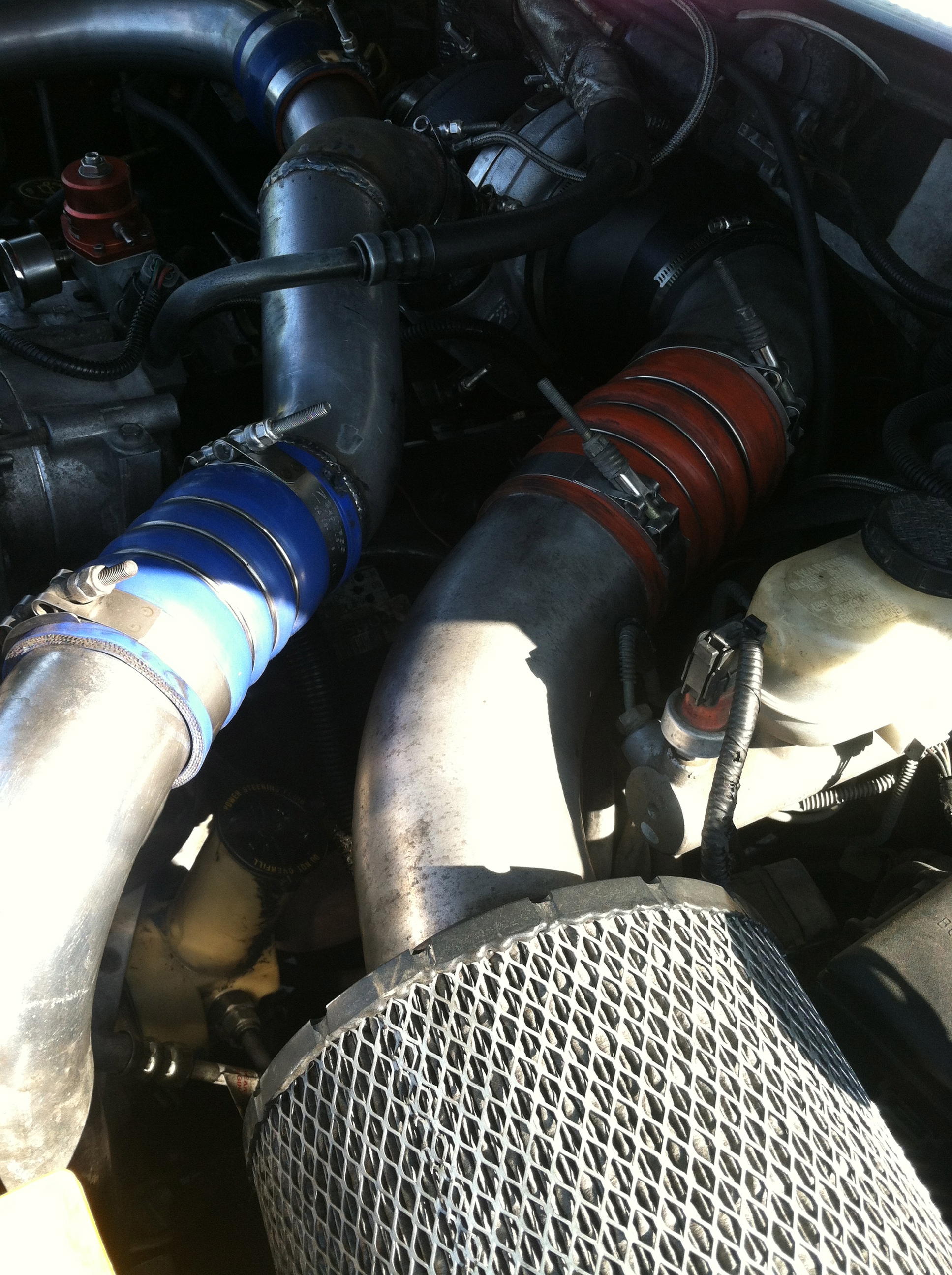

Hey Marty, just go get a reducing boot from the plumbing store, the 5" will stretch over the turbo and you can keep the valve covers in the stock spot.

Already done, having the CCV on the passenger side is nice though. Keeps the crap out of your driver side window.

I think he is referring to the crank case being vented to atmosphere on the other side so the smoke does not come up and in the window.

The race cover is 5.5". If you get the right boot, you can leave the valve covers alone like Matt said. The OBS looks tighter past the brake master cylinder than the Super Duty. I was able to get the 5" intake between the intercooler pipe and the master cylinder, but it is very tight.
