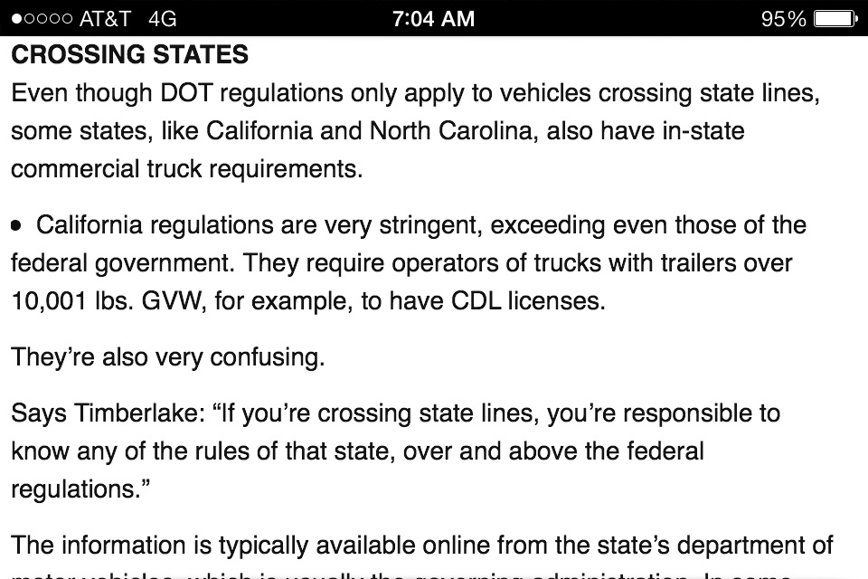

CDL regulations are federal law and do not change from state to state. Only the LEOs change from state to state, and their interpretation of the law.
jngreen
May 21, 2011
1,083
IN
They do change state to state. View attachment 21197
I think every state has that 10,001 lbs rule, but not every state enforces it. Indiana has that rule also. It pretty confusing.
