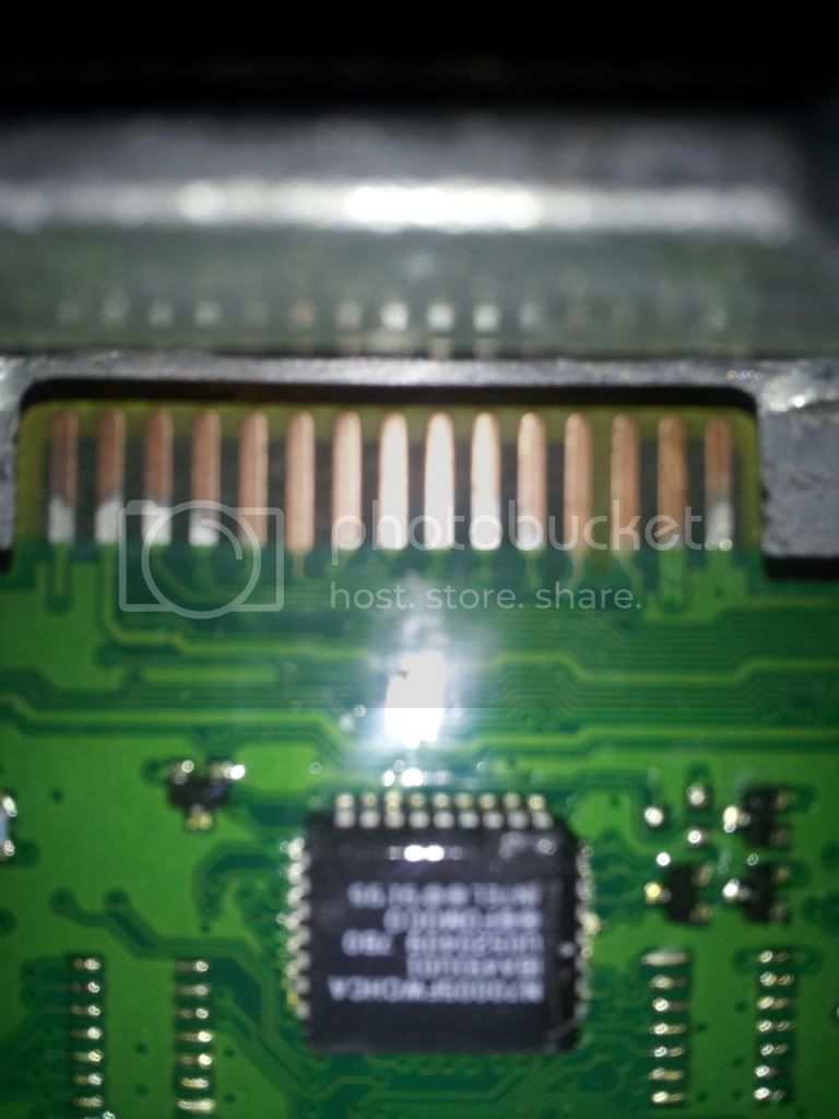

Most standard card edge connectors are designed to accept .062" to .064" thick circuit boards. As it happens, OBS computer PC Boards ('94-'97) are .062" thick so there is little concern regarding connection problems. However, '99 and later computers are only .050" thick and can present a significant connection problem, especially if you remove .001" to .002" of the tinning from the edge connector

IME, the biggest variable is how much material you take off of the PCB in the PCM. People that sand the bejesus out of it always have chip problems because it's too loose of a fit. If you take juuuuust enough to get down to the "tinning" on the pins and STOP, the chip will fit so snugly that nothing is required.
If you blast them down to full copper everywhere, then there's really nothing that can make it sit still anymore.

I'm still having that problem after you did work on my truck . It does the same thing. In the morning it seems to always start. But after driving it for a bit when I try starting it I notice the wait to start engine light goes out and the check engine light stays on . Most the time to fix it I switch to a different tune and switch back or turn the key on and off a few times. After your post I finally decided to pull out the pcm . I think I see my problem it was cleaned maybe too much down to the copper .. I think it was already like that. By changing my chip to the new one maybe it was enough to mess up the connection that it did have . I have also had my truck stall while trying down the road just from switching to a different tune. Not fun when your doing 55 on the highway.
