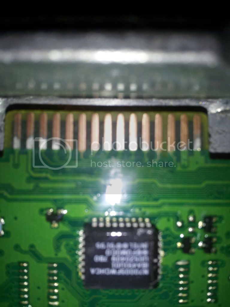

Think I"m going to send my pcm to swamps to have them solder the pcm to help build it up for a tighter fit. Unless that is some you have done . I can stop by your place and we can try that to see if it works. I really think that's the problem with all that copper showing.

I do not know if you cleaned it or not . It was a long day so I forget . I"m guessing it was like that in the beginning. Maybe from removing the old chip and installing the new it was enough to mess it up .. Who knows .

I'm still having that problem after you did work on my truck . It does the same thing. In the morning it seems to always start. But after driving it for a bit when I try starting it I notice the wait to start engine light goes out and the check engine light stays on . Most the time to fix it I switch to a different tune and switch back or turn the key on and off a few times. After your post I finally decided to pull out the pcm . I think I see my problem it was cleaned maybe too much down to the copper .. I think it was already like that. By changing my chip to the new one maybe it was enough to mess up the connection that it did have . I have also had my truck stall while trying down the road just from switching to a different tune. Not fun when your doing 55 on the highway.
You definately need that to be re-tinned. I bet any of the tuners are really good that that from fixing issues. I have done it before but am not as good as someone that has done dozens.

You can see some copper on mine, but the chip fits pretty snug. Once in a while my truck won't start on the first try, I have to cycle the key again, then it starts right up. Anyone think thats from too much copper showing?

I usually take off the slimy looking crap from the PCB until I think I have it all off the contacts and try the chip. If it doesn't work, I rub a little more off until it works. Absolutely none more than required to get contact. In my experience this makes the chip fit VERY tightly.

Do you have any copper showing like in my pic? And if you rub your finger across were it hooks to your pcm you should feel little humps were the solder is . Mine is completely flat .
Charles
2,729
47
This one has trace amounts of copper barely showing on the edges of some of them.
Running your finger along the board you distinctly feel each one.
