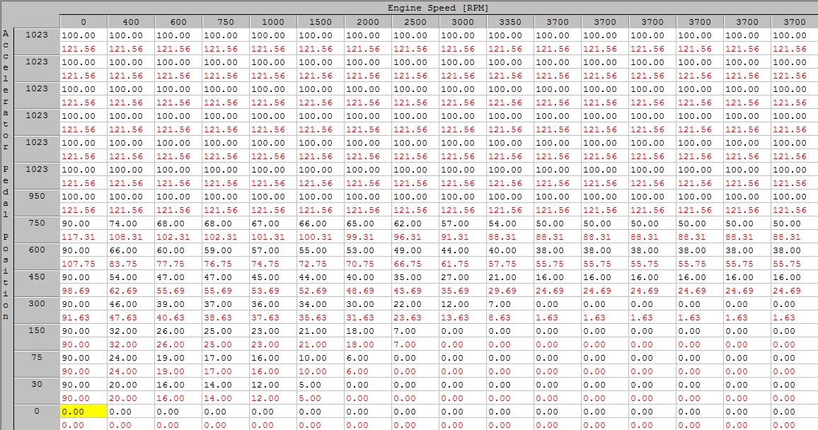

Looking at the whisper calibration I see we drop the ICP and add the -7% global offset SOI.

How do you go about seeing the files on the screen? Cant wait to start playing with minotaur.
When you load more then one calibration you can compare the values of each variable side by side. I don't even know what I'm doing and the software keeps amazing me! Here is stock vs 140hp MFD.

Keys F6-F10 toggle you thru the different views of the maps. With F9 you can see an overlay of the two calibrations loaded. Number lock toggles what your arrow keys are for.

When you buy Minotar Bill will send you his standard calibrations.
0=No foot on pedal
1023=Pedal on the floor

It goes from your right foot, which is the Mass Fuel Desired map, your right foot (pedal voltage run through an analog to digital converter yielding "Analog to Digital Counts", which are the numbers on the axis opposite rpm). From there you hit the Injection control pressure desired map, which is then based on the MFD value you just set and rpm. From there you get Fuel injector pulsewidth, which is based on the ICP value you just set and the MFD value you set earlier.
That is the order. MFD, ICP, PW. That is the conceptual sequence that gets from your right foot, into the cylinder for a given engine rpm. Start of injection independently decides when all of that times up with the crank.
