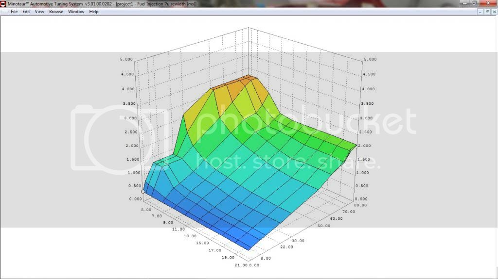

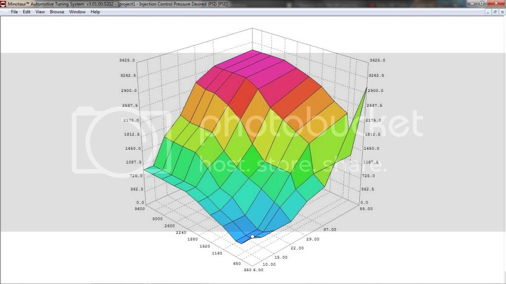

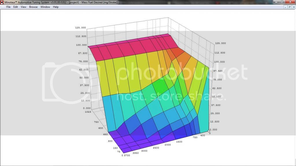

Heres some pics of the 3 tables that i think my issue is in, they all need some tweaks, just haven't gotten around to messing with them. This is my daily tune which is pretty clean, hazes under heavy throttle, and boost peaks around 35psi. Overall a very easy driving tune, but still runs pretty good.

Sorry can you post the number graph? And I can't see you're sig what are you running for injectors and who built them?
you do realize that mass fuel desired is simply your pedal curve right?
