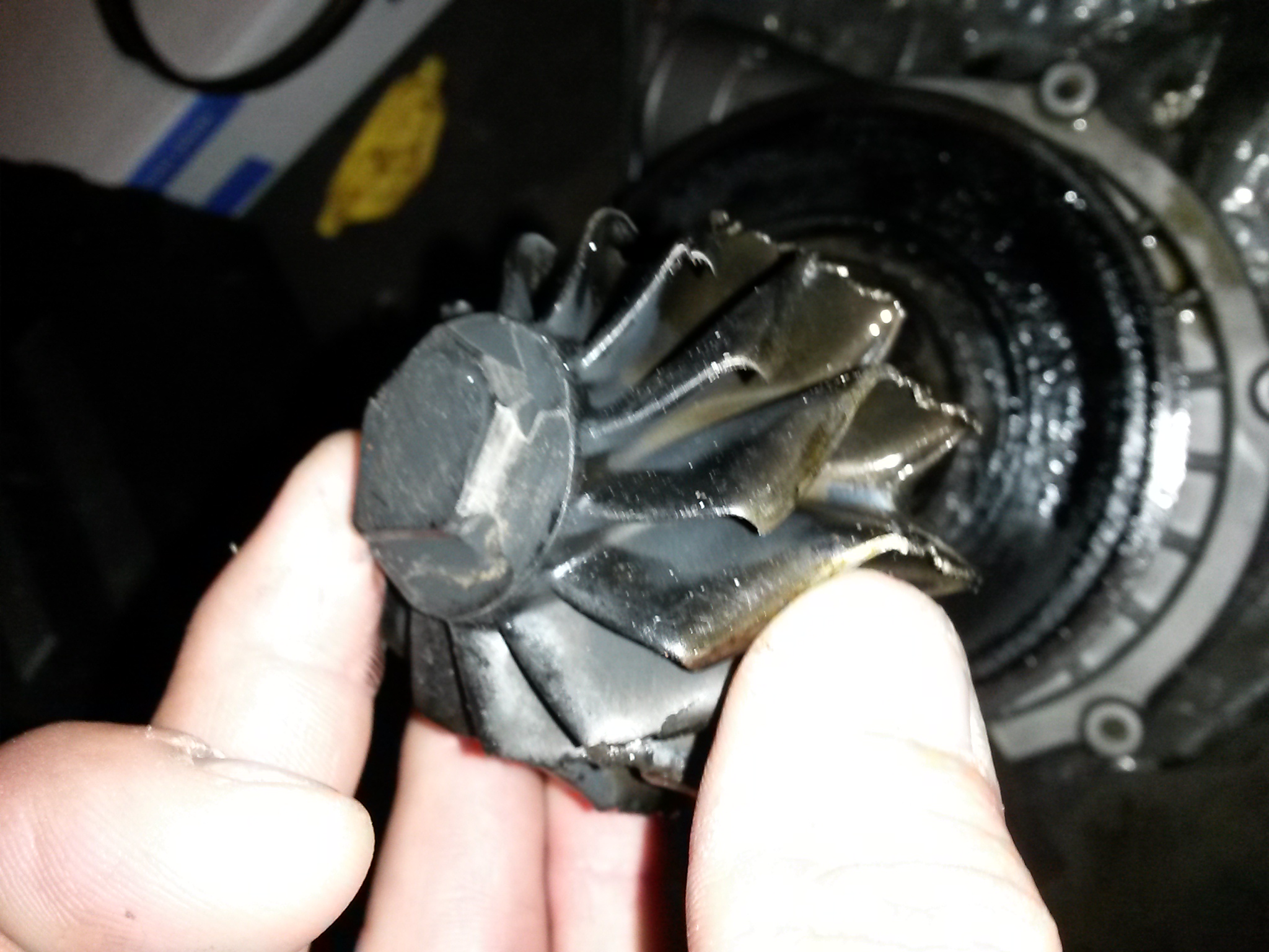

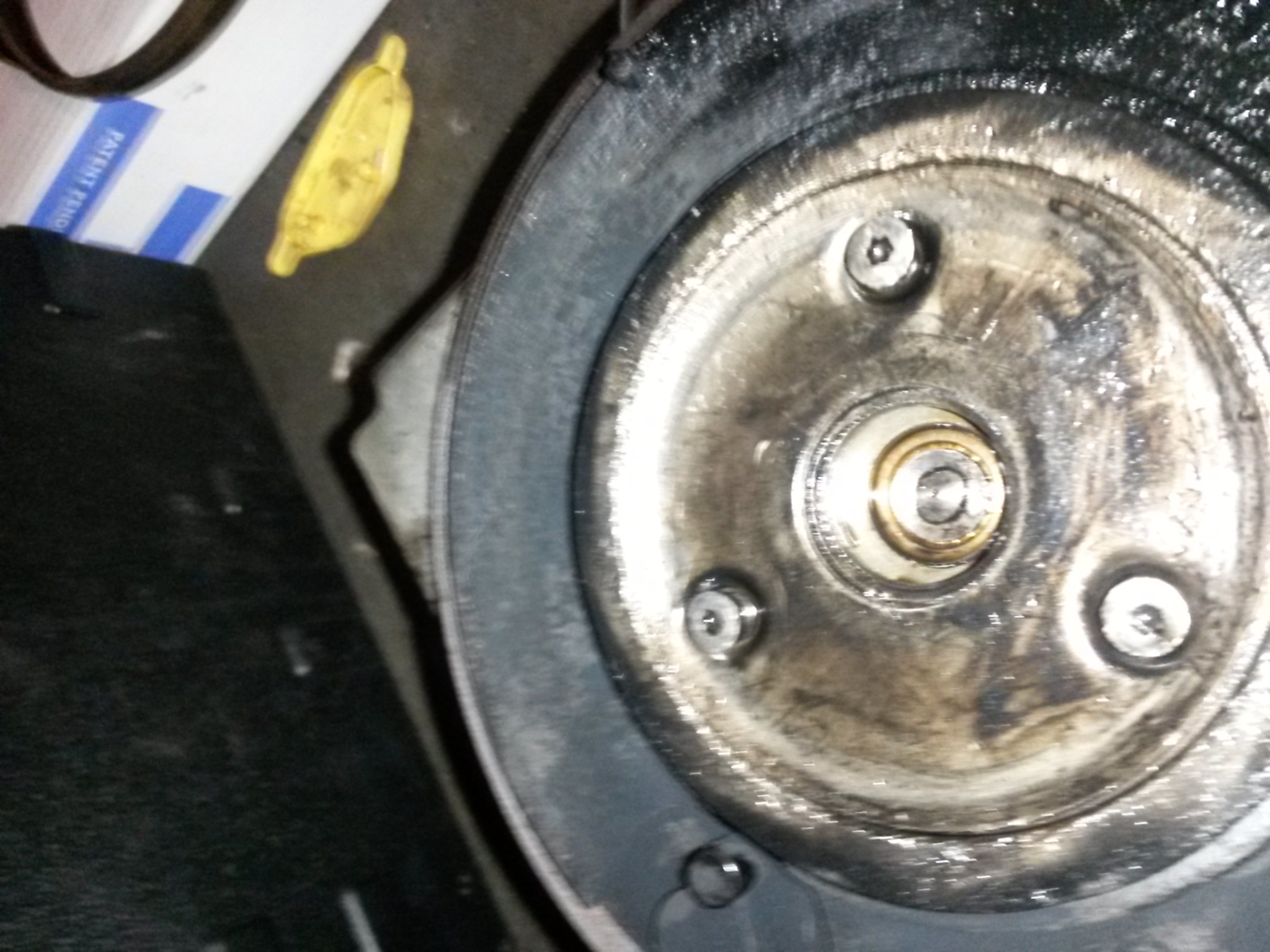

I took the blown up turbo apart.. this is what I find.. those 3 bolts were lose.. from what, I don't know. Could that have been a culprit?
RCD said I would be good to go on their 155/30's with stock turbo..
