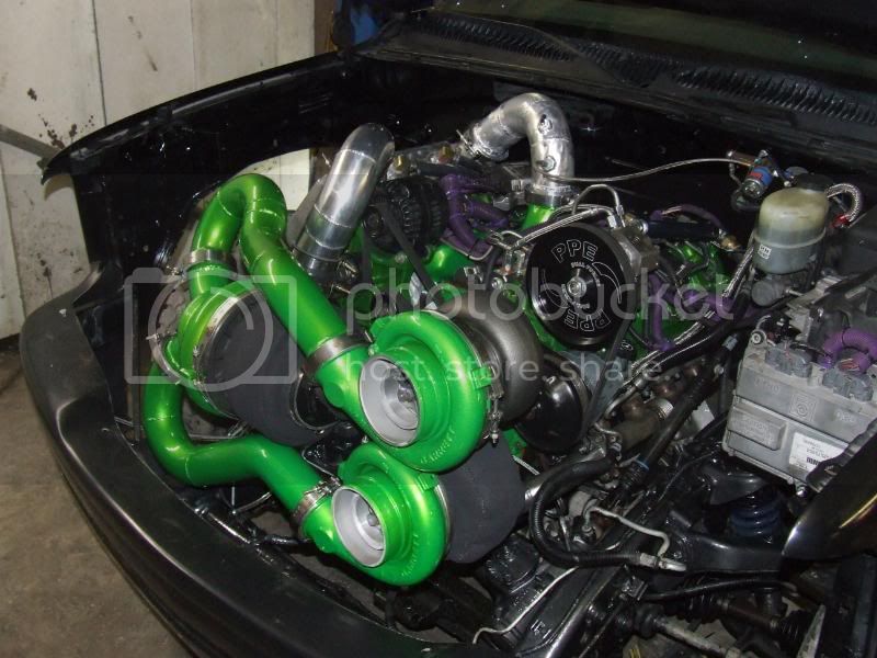

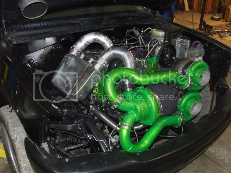

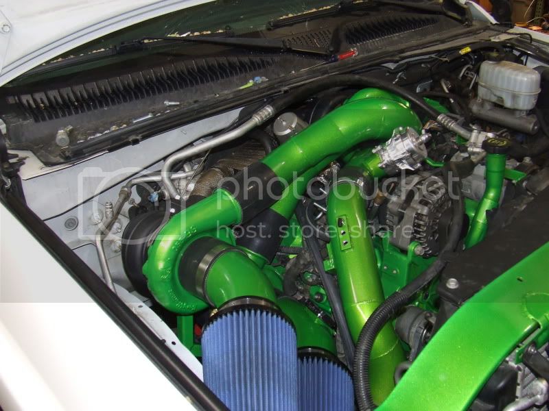

Here's my setup, sorry about the size. I was thinking of putting a filter on each inlet and not having that big j pipe there, i would just make a new pipe that y's each turbo outlet into the intercooler, but the hot side would be attached the same as above, smaller to bigger. I have no idea why I thought that would pull more air in opposed to my piping now. Probably more restriction with that second filter. I was thinking it would be easier on the eyes without the wrap around j pipe.
What I'm really curious about is doing the s300,400,500 setup. Would it be worth fabbing this up or should I stick with my compounds. If it's worth it I'll start making the bracket and save up for the s5
I can up the 75 to an 83. I didnt know if a s510ish charger would net me a solid gain over the compounds. If it's minimal I would rather just do two big chargers.
in order for this to work at all the s5 would have to be the only atmospheric charger. turbine wheel on an s5 is alot bigger than an s4. maybe thats the way your explaining it but thats not what im picking up. i think compounds would outperform it but i would like to see it lol.
