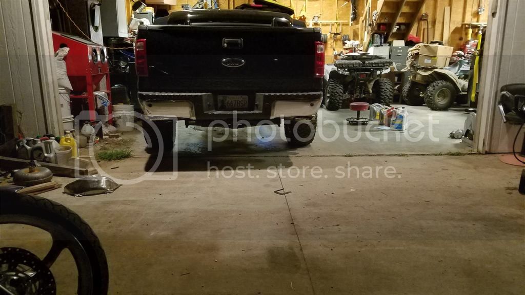

Slow progress. Received remanned heads from Ford. They looked good except UPS dinged up the edges enough they need to be touched up. I dropped them off at my local machine shop to be checked out so it will probably be Monday before I get them back. In the meantime I installed the new front cover, which comes with a new oil pump that I wasn't expecting so that is nice and i've still been soaking my intake to get all the pre-EGR ****** gunk out of it so I can paint it. All of you guys still running EGR, it has been soaking for 3 days with rinsing every day and still has a lot of black gunk coming out.

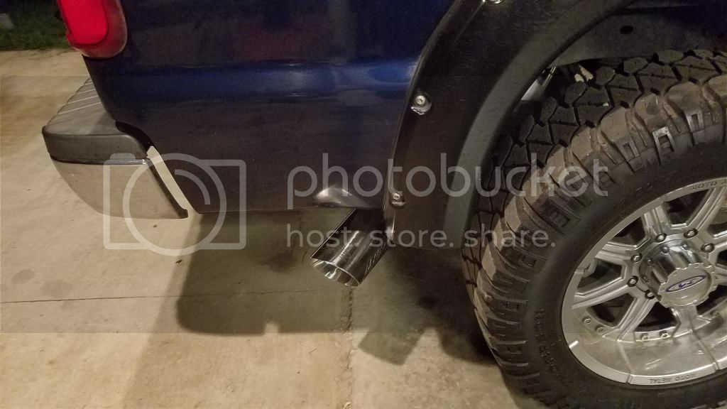

I also received the exhaust tips, but haven't installed them just yet. They are MUCH better than I was expecting for the price! Credit goes to Tom at Big Time Kustomz, thank you!

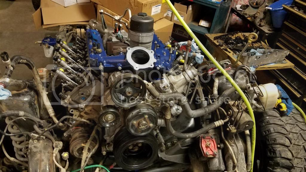

Got the heads back from the machine shop and started the re-assembly. So far, everything is moving along exactly as it should. I am really surprised the gasket set doesn't have a lot of things in it. Fuel return plug O-rings, seal where HPF line passes through lower valve cover, upper and lower valve cover gaskets, and a few others are not in there. I am also finding that many things that are included, are also included with the other items as well. Injector seals and injectors lines are just an example. I'm going to have some spares if anyone needs any.
On to the pics....
New front cover
Heads on and studs torqued to 275! Takes a little muscle to make that happen!

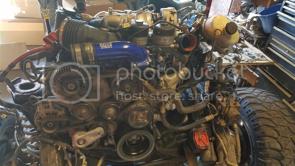

Pulleys, PS pump, intake, etc.
Injectors & rocker arms

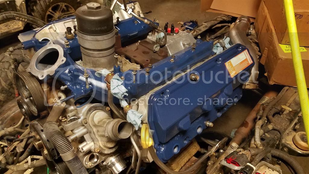

Valve covers just setting on to keep dust and bugs out. I'm sure they won't be very visible once all is installed, but they look good now.

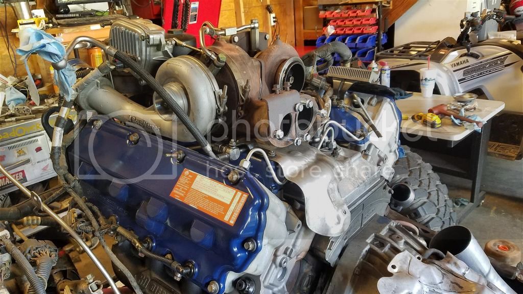

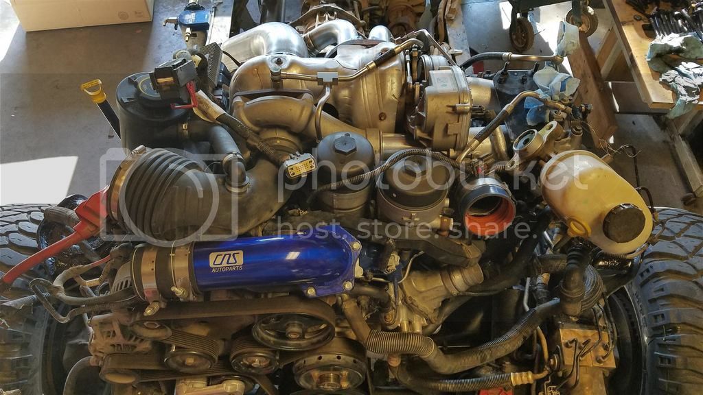

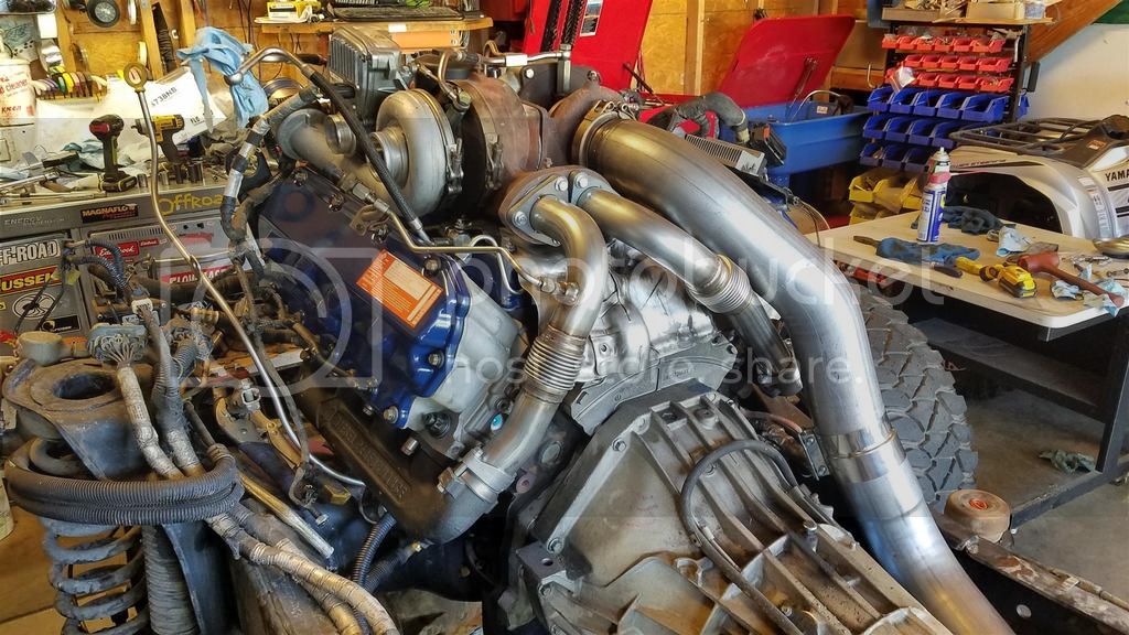

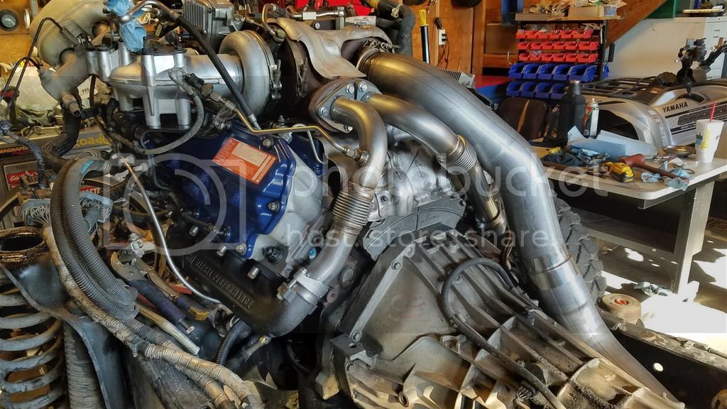

Got everything back together on Saturday and ready to put the cab back on. Did that on Sunday. All went as expected with no major issues, but did run into one minor one. Lower radiator hose is leaking. Evidently I didn't get the clip in right and it is leaking pretty badly. I pulled it off and re-installed the clip right, but it's still leaking so I'll pick one up tomorrow. That is the messiest hose to replace since you can't really drain it completely. AND, I feel for ANYONE putting on BD manifolds with the cab on! The passenger side is a pretty good challenge to get to the center two lower bolts! Took almost an hour to put it on and about 15 minutes on the driver side. Couldn't imagine doing it cab on. Still have a few things to finish up before firing it up. If all goes well, i'll be doing that tomorrow night. Anyway, on to the pics.
Turbo mounted

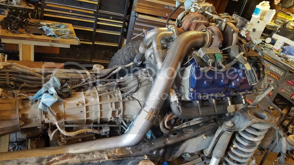

BD manifolds and up-pipes installed. Also the Flo-Pro 4" downpipe.
Sure looks good, too bad you can't see this view in the truck. haha
Everything good is hidden!
Remaining turbo tubes on and everything is bundled up ready for the cab.

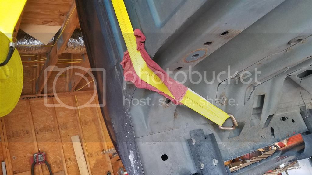

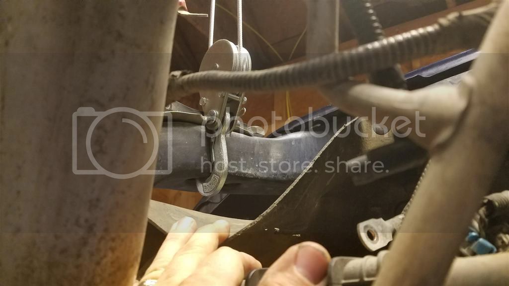

A few people was asking where I hooked the hoists. Here is the places I used
View from underneath passenger side. There is a perfect hole for the hook.
