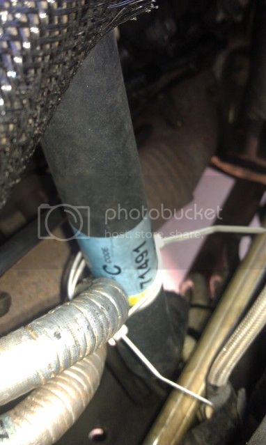

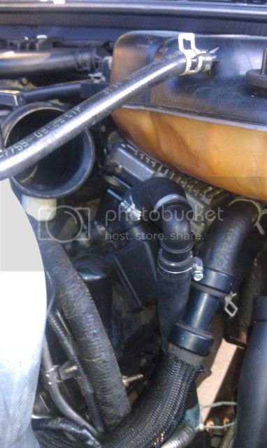

this is in the rear? i might do this...how did you connect the other hose and run it back down? 3/4 id to 3/4 id male/male fitting and clamps?
No...it's straight down from the valve cover to the frame rail inside the driver's side front wheel well.
This is how i routed mine as well, bought a preformed 18" hose with a 90 on the end of it for like 4.98 at AutoZone turned the 90 along the frame rail so any passing air will pull the fumes out.
can't smell it or have yet to have a single drip, if it does i'll stick a K&N valve cover filter on it dry not oiled to absorb the engine oil and change once all black.
Pics tomorrow when i upgrade my CAC Tube.

Dlinzy
Apr 27, 2012
68
Rotate Dog House Fitting up.
Connect AutoZone Hose # 71491 and route down to frame rail, turn to ensure 90 points to back of truck..
All Good for less than $8.00

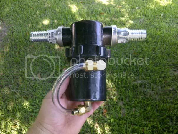

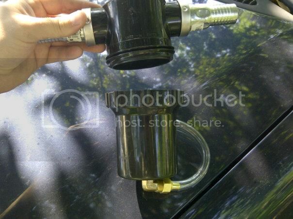

well, got the canister from TSC..plumbing from Lowes..got hose from the auto parts store..will be installing this weekend..still debating whether i should re-route it back to the intake or put a filter on one end and just drain it when its full..Do 03s really need the vacuum?
How did you mount the canister? I have mine run to the back of the cab but have not mounted the canister yet. Looking for ideas if you or anyone has pics? I have the same one in these pics. Thanks
