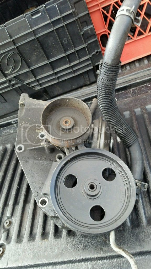

I was considering getting a remote power steering reservoir from Moroso when I do my power steering conversion. Looks like something I could make work with limited space for mounting. Very nice work there Peroni on the one you fabricated. I'd be another one that would jump in on a group buy for the one you fabricated if you decide to do that. I picked up the whole bracket with pump and pulley out of a 7.3 van awhile back so got the main parts needed already to make the conversion.
DZL JIM
913
North East Ohio
Figures, I just find this mod. I gave my van bracket away a month or 2 ago because I figured I'd never need it for anything.
Anyone know if the 6.0 pulley that originally comes on the pump will work?
I don't know how many of the ps pumps/pulleys I have thrown away over the past 5 years. They always come on replacement 6.0 motors I buy and when I get a pile of them, I get sick of looking at them and they go in the metal dumpster.

Billy my truck is a late 97 too - left the truck plant on the last Friday of November of 97. The pulley on right in my first post is my original. It is identical in every way to the van pulley pictured on left except the bore is slightly larger. Sorry I didn't think to even measure them until after everything was installed.
DZLJIM the 6.0 pulley will not work. I did a lot of searching and reading on this topic and so far the only proven correct part is the van pulley.
If someone finds a pulley from another application and verifies that it indeed works please post it up.

I couldn't get a pulley to match up and I tried a lot of them. For someone that wants a nice reservoir for fairly cheap lee power steering in California has one that can be custom made for about 200-250 with a nice billet bracket. You can have your fittings put on where you want them also.
