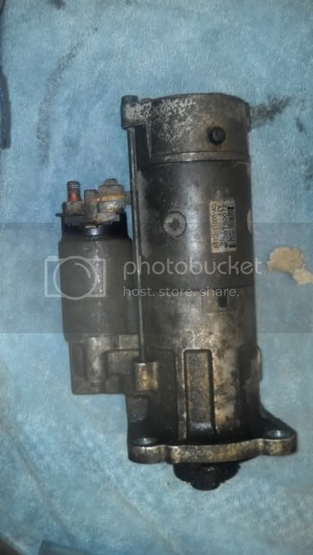

just checked the voltage while cranking, with known good batteries, no drop in voltage while cranking, however the starter slows down after just a couple times of turning the engine over. Pulling the starter as we speak and gonna go get a new one.
2000wa250
Oct 15, 2011
1,048
so heres the starter that was on my truck, when we checked the voltage we could hear the starter slow down cranking, but saw no voltage change at the batteries. I believe it is the OEM one, and it definitely seems to be cranking slow. Not sure if its slow enough to cause a no start, but I'm going to replace it with a brand new one. Regardless its peace of mind to know that I now have a new starter. Especially given that I dont have to turn in this one as a core so I can have it rebuilt eventually. I believe we are getting fuel, but due to the fact that the new starter wont be here until tomorrow, we couldnt really do anything else on it today. Will be checking to see if I have fuel coming out of the lines returning it to the regulator.

Yea, that has been my hunch from the beginning ken. The question for me was whether it was because it was pulling the voltage down (we learned this wasnt the case) or it wasnt spinning the engine fast enough to build pressure and clear out the air, not to mention actually have it fire off. It's been working lately, but has always had a bit of a long crank in my opinion, so the air plus the bigger injectors that must be pressurized, along with the fact that we had to use it to crank the engine over for an extended period to clear the oil probably was just too much for a tired starter. Either way we will find out tomorrow.

I bet it is the starter also. I mentioned the 42 pin connector because I have seen a case of somebody just smashing it together and bending pins. I have also seen a case of "oops, I forgot to connect that connector". Not knowing you, we sould never ever assume anything. Also, I am not trying to dis you at all. Just reminding of the basics.

Don't even worry about it. If it ends up being the starter im going to kick myself in the face because I blew off replacing it 2 weeks ago

Was not the starter. Replaced it with a brand new unit, spins over MUCH faster now, but still will not fire up. Thinking I might be back to the IPR or a bad CPS. If the IPR got stuck open, is there a way to reset it? Can i unplug the back of it and then replug it?
