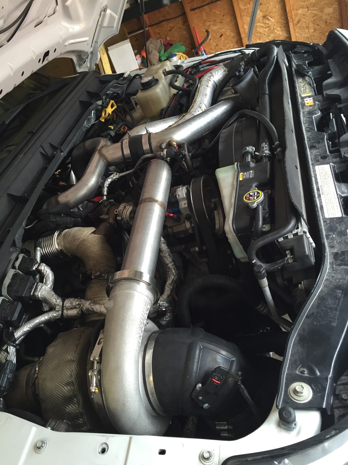

Ugh, that engine bay makes me sick with envy... Get a new coolant tank, it's junking up your bay! Lol, any plans on painting the pipes?
Six_Sloww
Dec 5, 2013
2,574
Southeast MI
Probably do something this winter. Right now the engine bay is all business, I'll do some beautification while the truck is stored.
Notneb
Jun 26, 2015
1,733
Oh yeah I didn't mean anytime soon. I figured you'd get your build figured out and perfect first, just had to ask!
