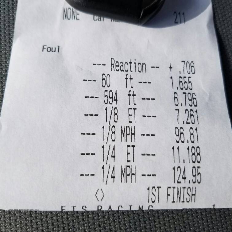

It's just the way I have the low pressure system setup, when I get a chance I'm going to separate the low pressure systems.
The fuel cooler did what it was supposed to do, fuel was around 100 degrees today.
Mph puts it at 1060 at the tires on a 1.3ms tune... Pretty stoked about that.

compd and our calculator are 20% loss . most gasser calculators read a good bit higher due to 15% or so . i'd say its 950 ish on that pass.
Which sounds about right, it was a 1.3ms tune so I have room to turn it up.
I also want so say how awesome the ouo stuff is on this truck. I was cutting 1.6 60's leaving pretty soft on cooper at's.
Alltogether it makes for a lot of fun... it's effortless to spool, launches pretty drama free, probably try to lean on it a bit next time until they tell me to go home.

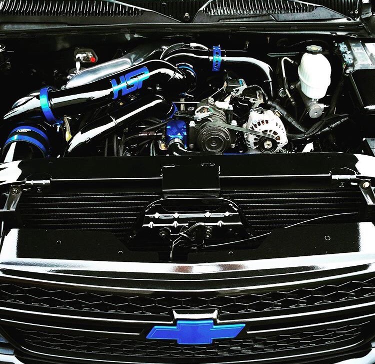

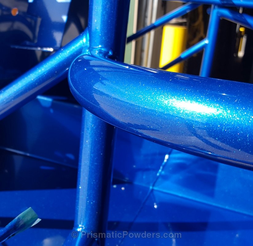

So I'm not one who really does aesthetic stuff on my truck.. But I think this will be the one I start on.
Anyone have any input on what I should do with the piping?
I'm plain, so my first though is black pc... Maybe spice it up with polished compressor housings and clamps?
And yes, it needs a NL degas bottle and battery tray.
