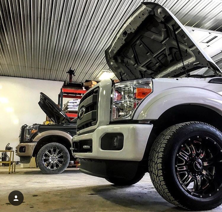

So some of you know I bought Morgan@Midwest's 6.7 regular cab last year. I think the truck was for sale for about 30 seconds when I decided I had to buy it. Sold my 6.0 that Wednesday and drove down to Athens IL that Friday to pick it up.
I loved the idea that the truck was "done". The plan was to just enjoy a well built, heavily modified truck instead of always tinkering like I did with my 6.0.

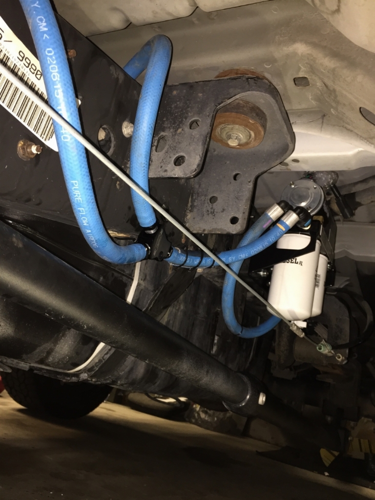

I daily drove the truck up until it was time to put it away for winter, didn't do anything to it besides add an airdog 165 4g to it..
Awesome pump, the 4g is quieter than the oem pump and has held up to the biggest fuel only tunes.

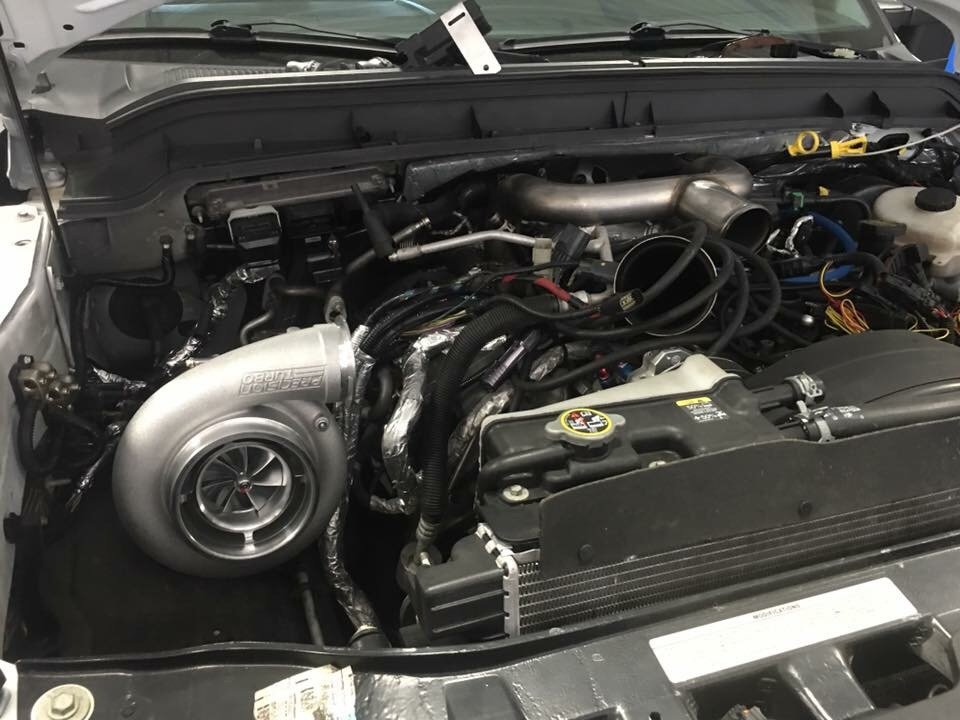

Well Morgan's new sales guy (Jared) talked me into one of these guys..
Precision Gen 2 8891
I drove the truck down a couple of weeks ago and after not even 6 months after leaving the shop it's back at Midwest Diesel & Auto gaining a turbo!
When you put the airdog on, did you bypass/****** the factory low pressure fuel pump or do you still have the airdog feeding the factory pump?
Six_Sloww
Dec 5, 2013
2,574
Southeast MI
Airdog fed the factory pump, works okay but doesn't increase overall volume much, if any.
